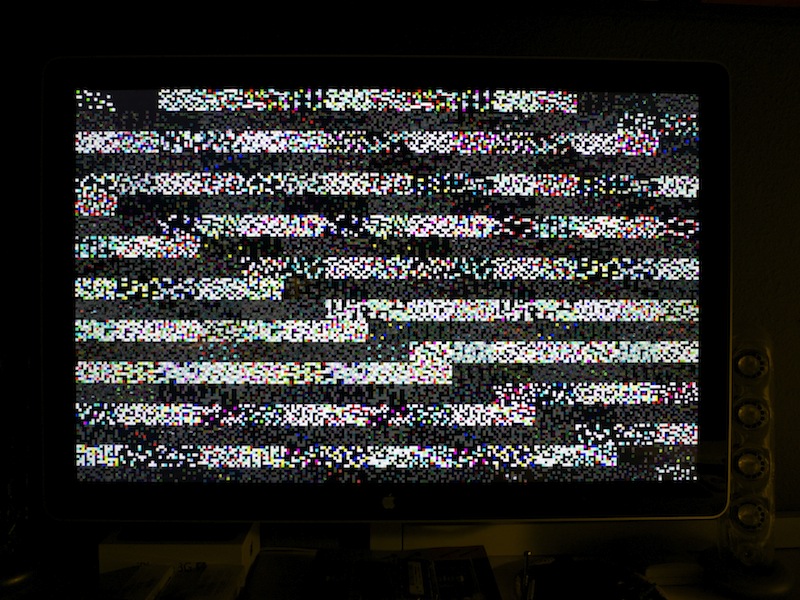

Radeon Sapphire Radeon 4890 HD 1GB Vapor X and displayport - sleep issue
Hi again!
Thought everything was a-ok, until I put my Mac Pro to sleep 🙁 when I woke it up again I got some nasty stuff on the screen, and the computer kinda froze.
Anybody been there? Anybody know how to fix this?
Regards
Claus
