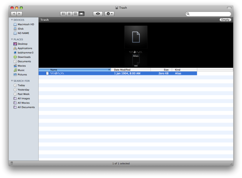

Any idea...?? I couldnt delete it using any method
Try going to the Finder menu and choosing Secure Empty Trash.
But, be sure that the file is unimportant first.
If that doesn't work, I don't know. But, Secure Empty has always worked on the ones that I couldn't remove before.

My situation is same as yours on every aspect!!!!! What else can I do? the file is created on 1904 WTF....is this a virus?
