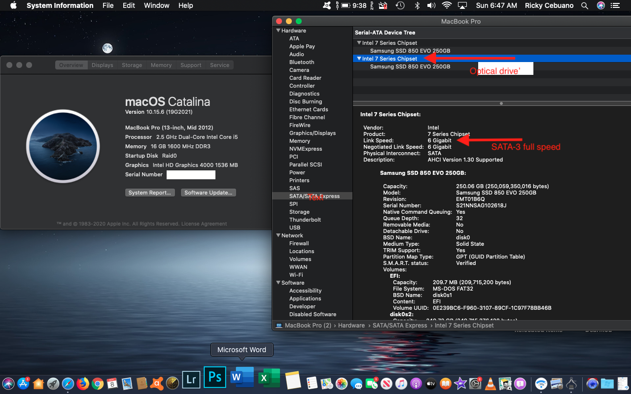

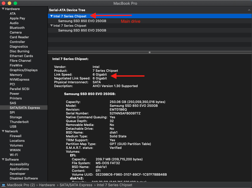

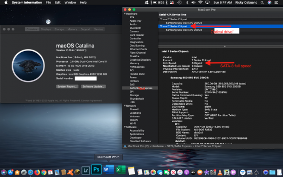

The main connector for 2012 MBPs is SATA III, while the optical is still SATA II. You'll get ~500MB/s reads on the main SSD and about half on the optical.
Well, I was no help but I'm glad you got the drive running!

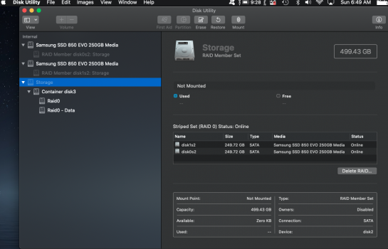

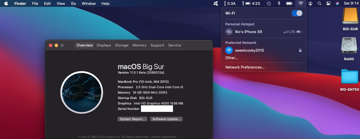

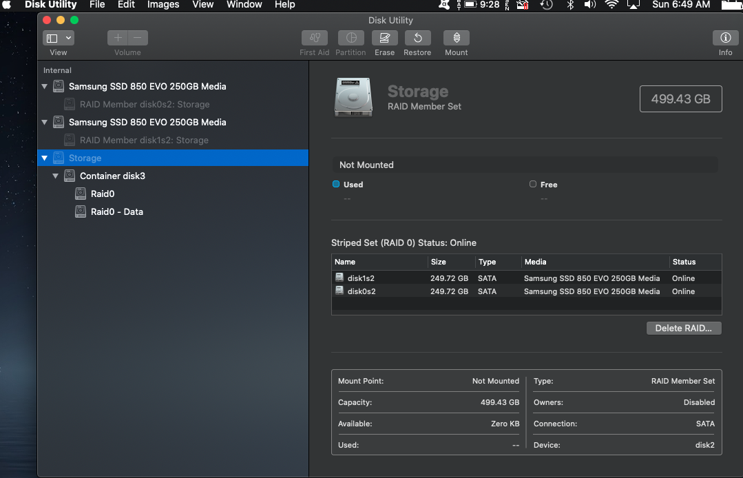

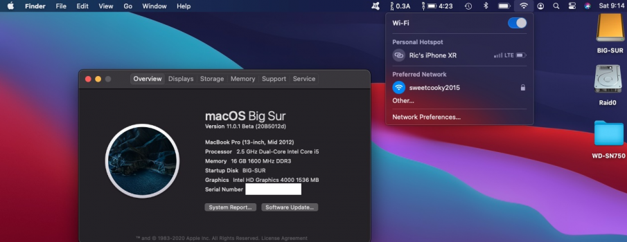

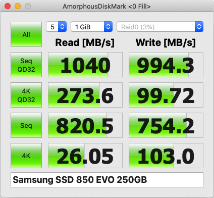

not exactly true, Mid 2012 13" Macbook Pro 13" non-retina optical drive runs full speed SATA-111 6 gigabit link, i have it running RAID-0 with catalina, it runs extremely well with Big-Sur release candidate.
