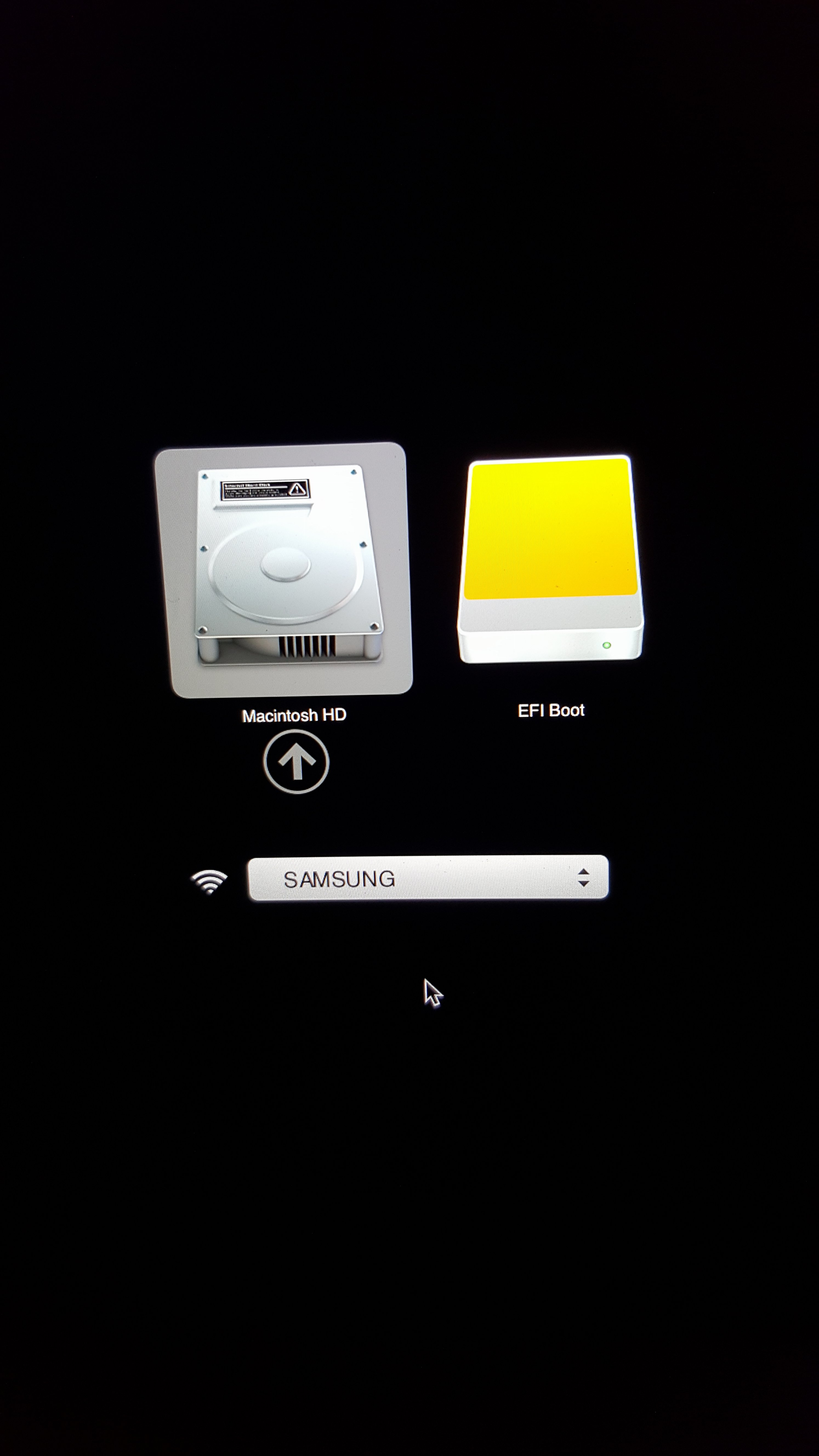

Thank you man we have no apple store , when I hold alt I got only efi boot like the attached pic

Is this all you are seeing even with a USB thumb drive in with the windows install on and the windows drivers ?
IE you don't have the option to boot from USB
