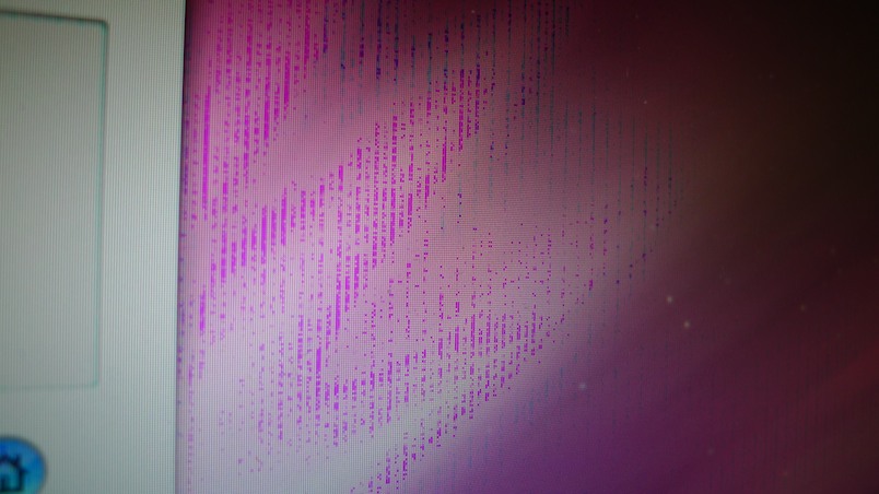

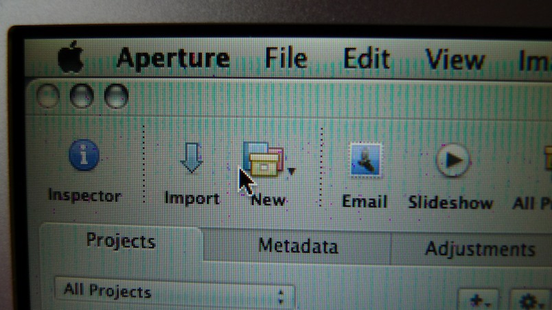

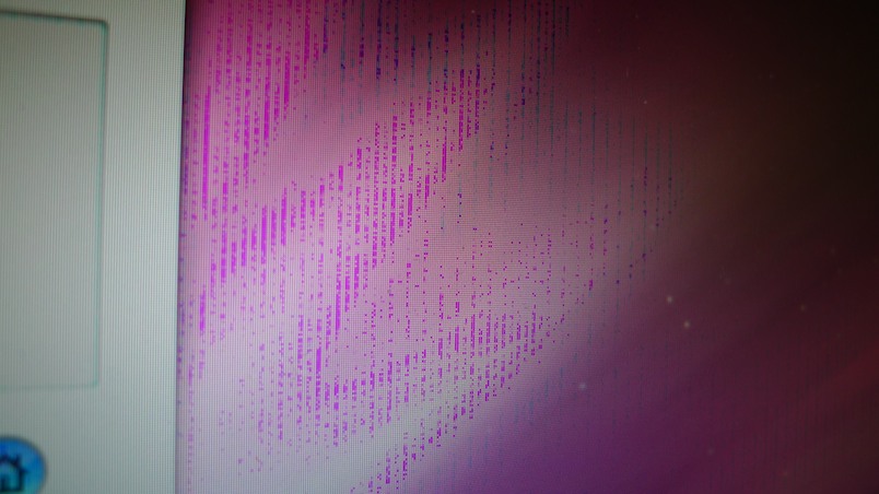

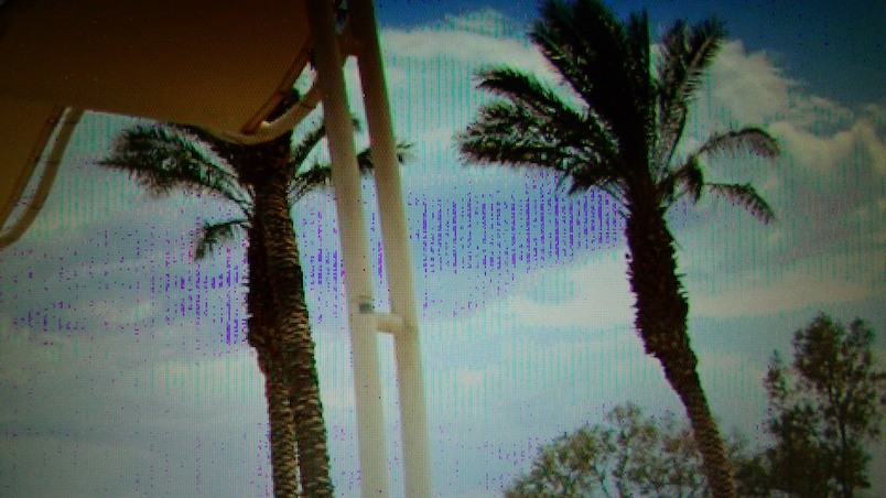

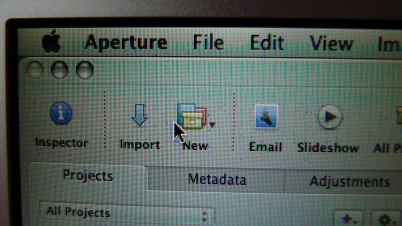

Has anyone had any issues with the 9600m card. I have been getting blue lines that go away with a reset. They have been takling about this on the Apple Support site Discussions. When I called Apple they want me to send it in for repair. They will not replace since they shipped in on the 19th (over 14 days ago).
These are pics from the Apple Support site Discussions and show the exact problem I have been having.

There was another member on this forum that is having similar issues. Some say it's a firmware problem that can be fixed if a firmware update is released. At this point, it's really up to you if you want to go back to the Apple Store and have them replace the unit for you.
If you got the stock model, then it would be well worth trading it in for a new one. Hopefully an Apple store near you will have some out back and just swap it straight for you, minimising any down time without a Mac.
You can try to chance it out and see what happens... Though I don't get a good feeling about the whole situation.
