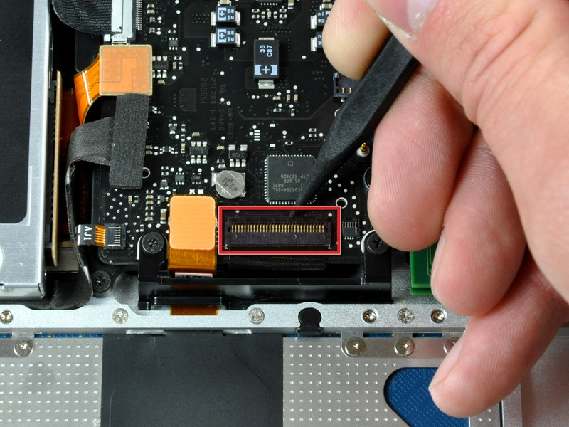

It sounds like the late '08 MB aluminum unibody. Removing the parts to get to the Airport card shouldn't have disconnected the keyboard cable, but if it's not connected, the power button wouldn't work.
I'd suggest a SMC reset. Links to the proper reset procedure are here: http://support.apple.com/kb/HT3964?viewlocale=en_US
Could you give me a general idea of where that would connect in at?
I take it resetting the SMC didn't help.
Anyway, it's connected to the logic board on the edge opposite the fan, between the memory connectors and the optical drive. There should be a bracket "keeper" screwed down over it. It normally wouldn't be disconnected when replacing the Airport card. I supposed moisture could have entered it, so maybe disconnecting then reconnecting it could help. It's a "locking lever" type of connector, where you flip up a latch opposite where the flex cable enters the connector.
It seems like you're looking for this?
P21gMUkStuLkuxls.large
Right above the track pad.
Source
And relevant troubleshooting guide
Re-checked all the connections, pulled everything out... none of the water sensors were even red....
Anyway, somehow, someway it seems like something shorted out the 4th pin on my keyboard connector on the logicboard... so I'm pretty sure that this things going to need a new logic board....

Sure, I can take a look. Was it one of the pins on the back of the connector (where the spudger is being held in the pic posted by waffle911)? If so, I'm guessing something happened in the process of replacing the Airport card. If they're mushed together, you could try a piece of non-conducting material (piece of plastic something-or-other) and bend them apart. Sometimes, the components are more resilient than most would think - just removing the short might bring it back to life. Besides, there's not much to lose if you're looking at logic board replacement anyway. :(
All flat film cable sockets manufacturers insist on opening and closing the retaining clip using your fingers only and never any tools like pictured above (unless you intend to snap it in half.)
