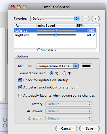

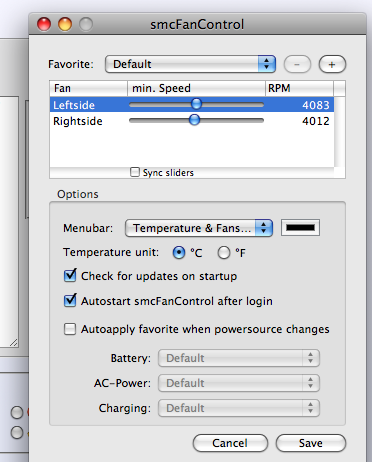

another good solution
i found a way that you can use your macbook pro 2, 53 with grafic card 9600gt gaming or other stuff and
THE BLACK SCREEN OF DEATH WILL NOT APPEAR
use this solution as your own risk
-download smcfancontrol for mac
http://www.macupdate.com/info.php/id/23049
put the fan 4000rpm as the picture above
start any game , and you will see that your macbook pro 2,53 will not crash.
after finish the game return the fans to 2000.
note:i play fall out 2 (9600gt)max resolution with hardware 3d on for 1 hour an never crash.
conclusion :
-the problem is really that the the grafic card hover heat too much and crash avoiding to damage
-avoid to repeat crash
-the fan in normal use 2000 rpm arent capable of colling the grafic card
-the fans mantain speed 2000 when the game starts.
-fans at 4000rpm keeps the nvidia 9600gt colling down and no crash has verified
-its obligation of apple to solve this problem , not a third party software.
-i will take my mbp 2,53 to apple store asking for a replacement
