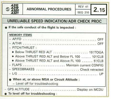

Unless, of course, you're on a ScareBus and your pitot tubes ice over.
From what I've read, the AF447 crew did not perform the unreliable airspeed procedure.
I wonder If the crew had an iPad if it would have helped them work the problem. Of course since they didn't use the printed manual, they may not have consulted an iPad either.
