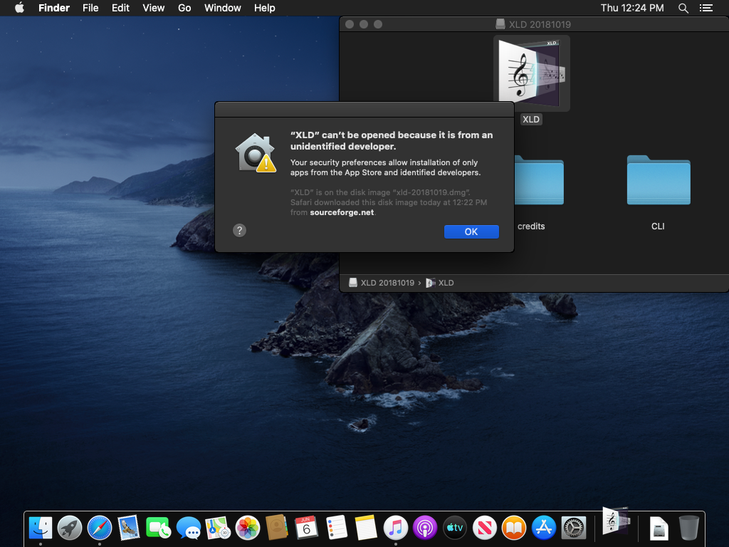

But the real question is, can you still right-click to open an app, bypassing Gatekeeper?
There are a few open-source app developers out there that don't want to deal with all this, and just let users override Gatekeeper to run their software. I want to know that the Mac is still an open platform (unlike iOS) and isn't essentially requiring permission from Apple for launching apps.
before anyone panics... can someone running catalina confirm? seems we would still have the option to bypass if we need to...

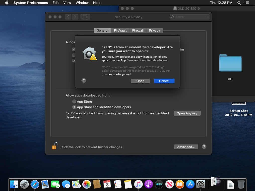

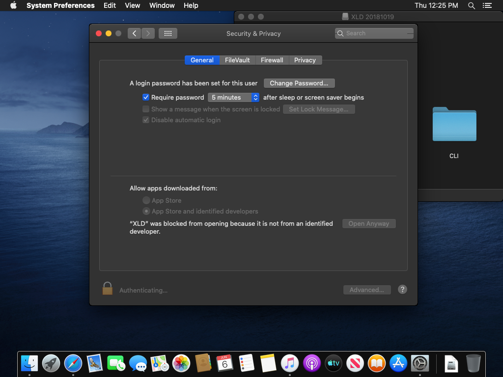

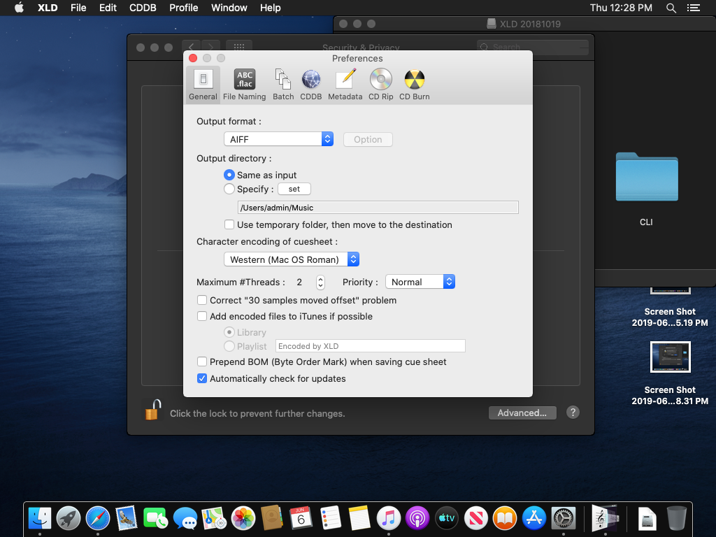

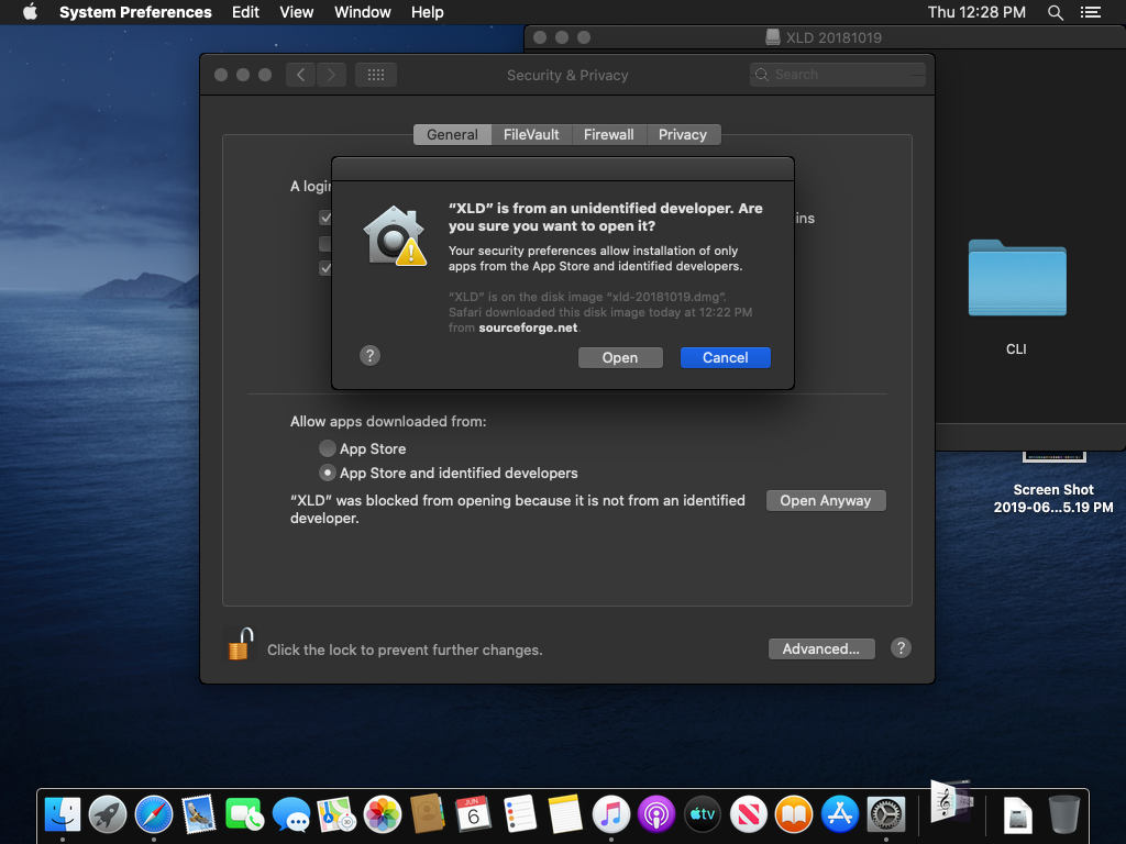

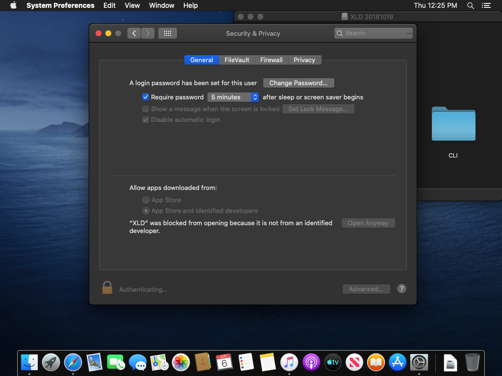

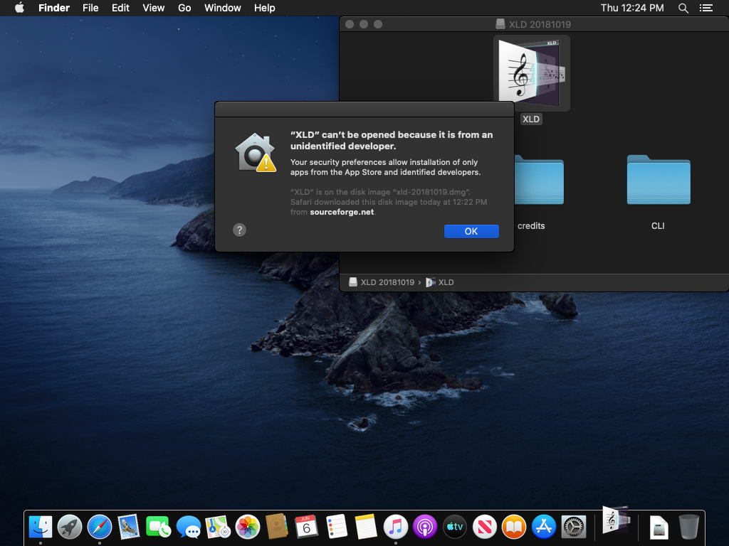

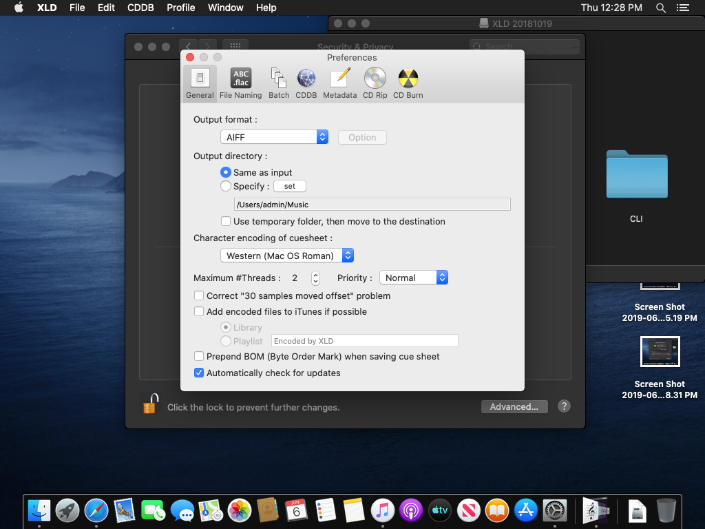

Okay, so it's not as nice as I'd like. You have to go into System Preferences and manually okay the application - you can no longer just right click it and force open it.

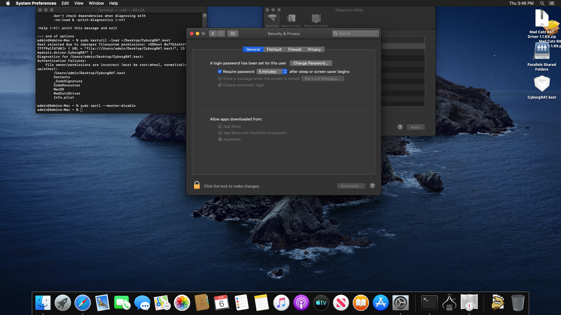

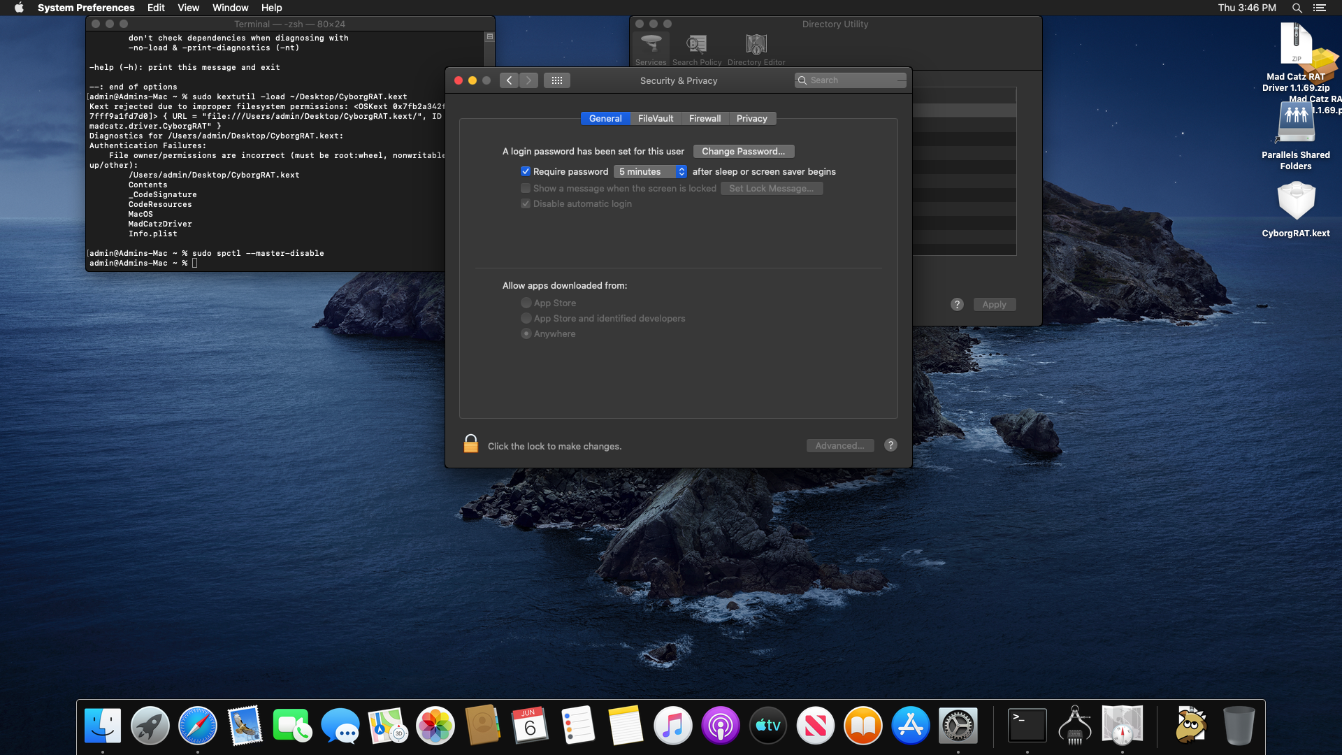

Try to enable "from anywhere".
In Terminal, type following command:
Code:
sudo spctl --master-disable
...hit enter, type password, then hit enter again and see if it works.
If "Anywhere" option shows up, try to install and open unsigned app now.

I can't find another unsigned app to test, but running that command did enable the "Anywhere" option!

Hm, good.
Now, I cannot remember some app that you can test out. Maybe others can help.

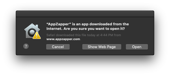

Try AppZapper. It is from unknown developer, but it seems a little shady. Also, according to Apple control clicking the app should bring up the "Open Anyway" option, but that support article is dated May 14, 2019, so...
Ironically, after I opened it, macOS told me it wants access to my contacts. Shady indeed!
