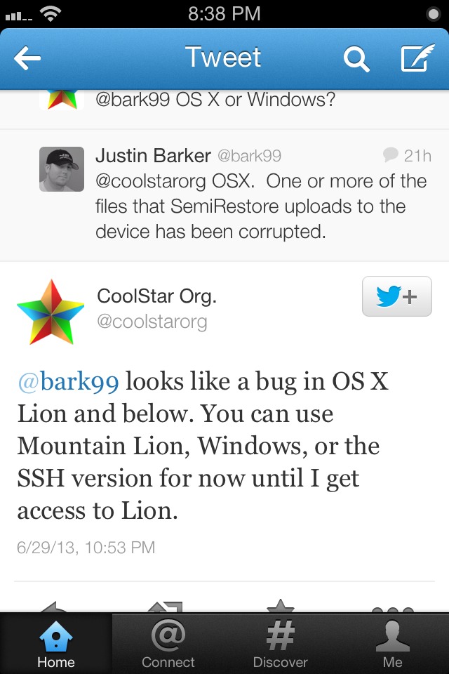

ok, every time i download semi restore, and i open it, it says ads corrupt. mac with lion 10.7.5. any suggestions? also, iPod touch 4g iOS 6.1.

But you do realize this is an issue with your machine only right? I mean, the tool works, just not on your computer.
What's the probability of someone find out the culprit?
I would say, reinstall the OS. Clearly there's something wrong with it. 😕
So, my mac is the problem? I just did a reinstall of lion a month ago... I dont want to have to do that again...
It's not your Mac. There is a problem on Lion and below. The developer said on Twitter that you should use Mountain Lion, the SSH version, or the version for windows until he has a chance to get access to Lion.
So i should download ssh?
If you want to run the tool and don't have access to Mountain Lion or Windows then I guess that's your only option at the present time.
