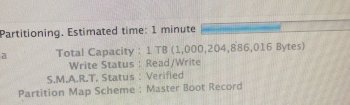

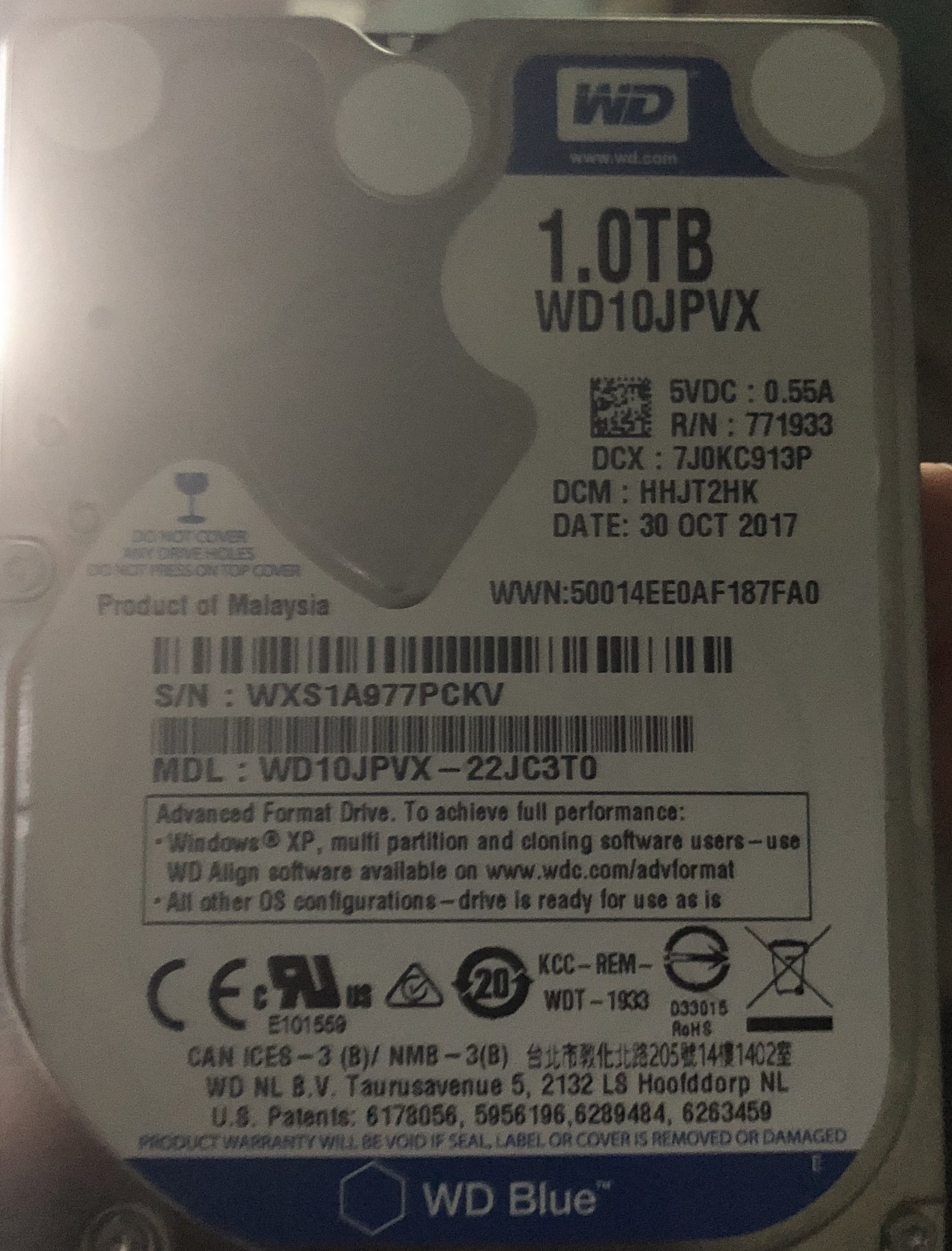

UPDATE: I got the new hard drive to show up by putting tape on the cable but now it won’t format it gets stuck in the middle and it goes from 1 minute to 9 hours
If the cable is the problem why would it work with Toshiba hard drive. And what are the chances I got a faulty new hard drive could it be something else.
Below I attach a photo of the loading bar getting stuck I don’t get an error or anything
but when I hook up an old Toshiba internal drive it shows up.
A couple weeks ago I got the folder with the question mark thing after updating. I tried everything in regards to this topic google could find and finally accepted that the hardrive was dead. so today I finally had time and money so a bought a new one. Now It won’t show up in utility disk in recovery mode.

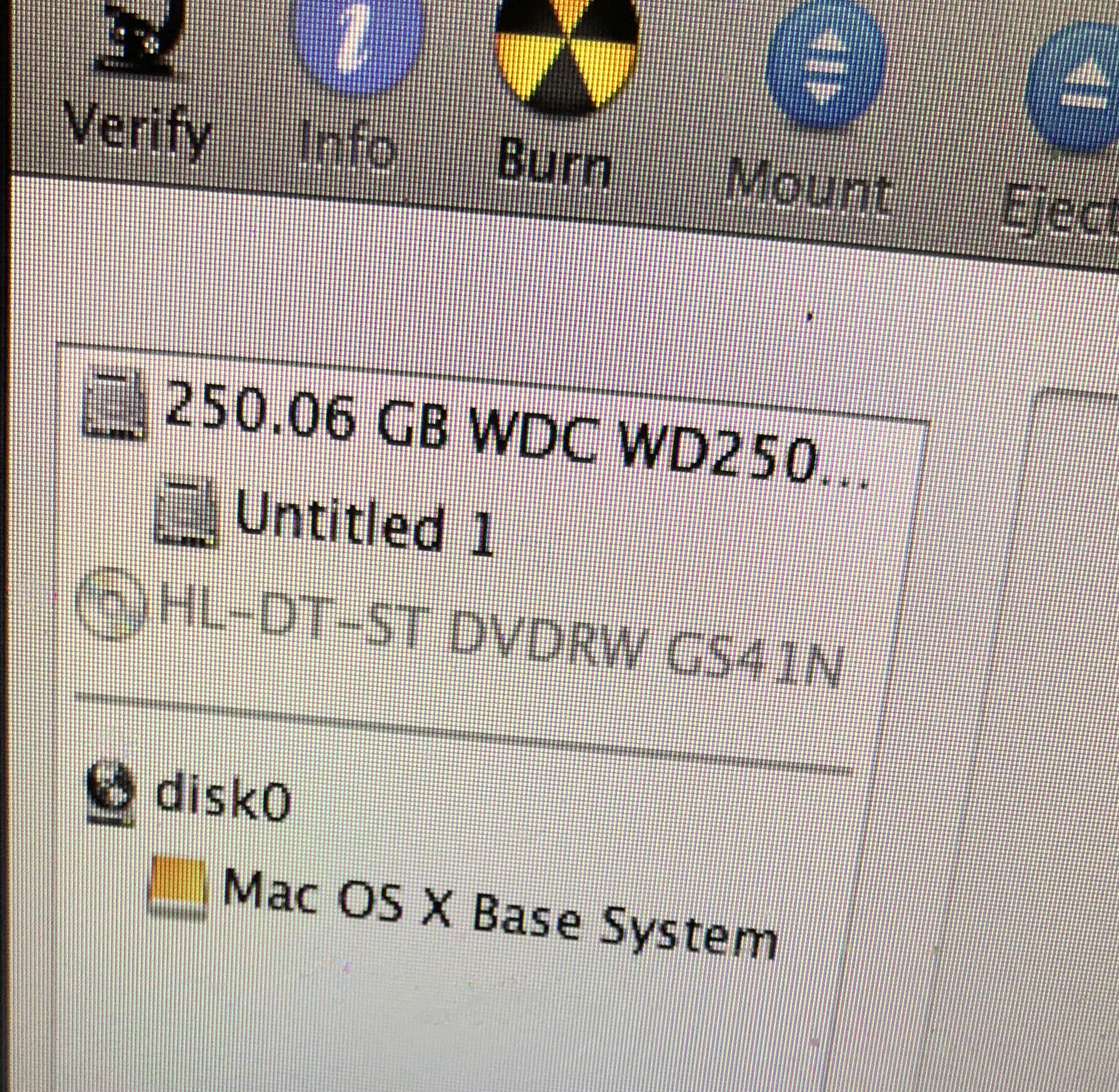

However just to see if it were the connector/cable/ribbon I took the hard drive (250 GB) out of my 8 year old Toshiba and when I booted it up in recovery, it showed up. I tried to reformat it by the “erase” method and I had no luck, the OS wouldn’t install.
What can I do now?????

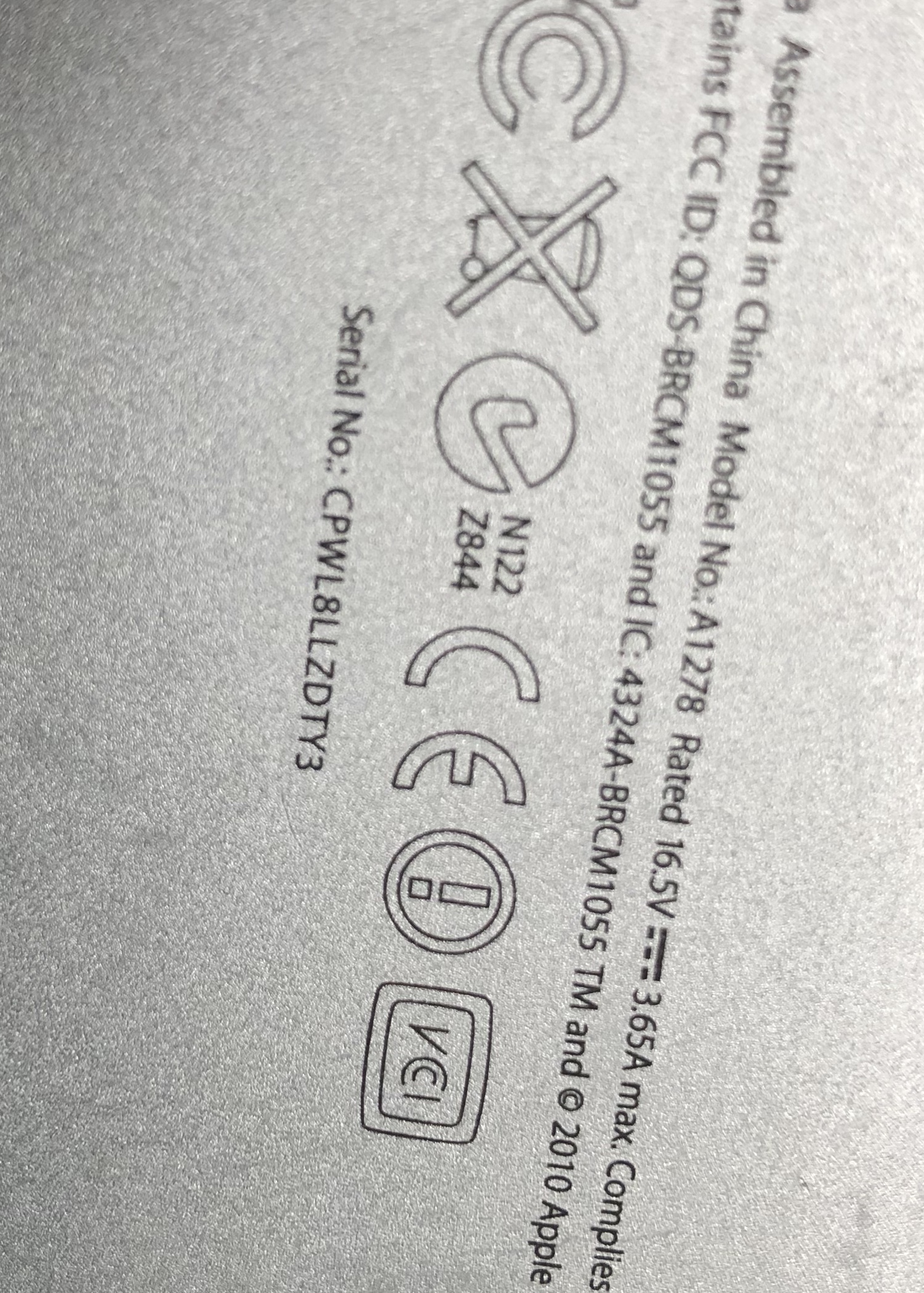

Photos below: what utility looks like when I put the Toshiba hardrive in, model number from the back of the laptop, and the new hardrive I just purchased.
If you need more information let me know.

I can’t do that because it won’t even show up. I don’t even have that option right now
Get a replacement drive cable. You did not say which model Mac Book Pro you had, but is seems you are replacing a rotation drive so it must be 2012 or older. The drive cables on these system are known for going bad, leading to intermittent failures and pulling of hair.

Probably a faulty cable. Yes, it may work on some drives, but not on others (or can be really intermittent - not a good way to use a hard drive).
One thing that you can try is to put the Western Digital drive in an external USB 3 case, and try to format while it is connected through USB. That will at least tell you that the drive is OK, and would be another way to know that you need to replace the internal cable.
Be sure when you format the drive that you change the partition map to GUID, instead the current Master Boot Record (which would be good if you were installing Windows. GUID is better (and the only way that OS X installer will allow the install) You can change over to GUID in the partitions tab in Disk Utility when you erase the drive again.

But, the internal SATA cable is not optional - if you want to have an internal drive. We are talking about different "cables". The cable, in my post, is the ribbon SATA cable used internally in the MBPro that the OP has, which is a Mid 2012, 13-inch MBPro. Those cables are known to be quite fragile, but easy to replace.

It's the ribbon cable.
A faulty cable -may- be able to work ok with a platter-based hard drive, but the same cable WILL NOT work with an SSD. It happens.
The easiest way to "work around" this is to have a way to connect the drive -externally- via USB.

With it, you can boot and run the MacBook "as it is" (even with a faulty cable) -- until you get the cable replaced.
