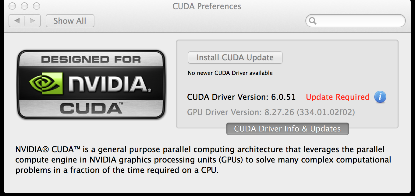

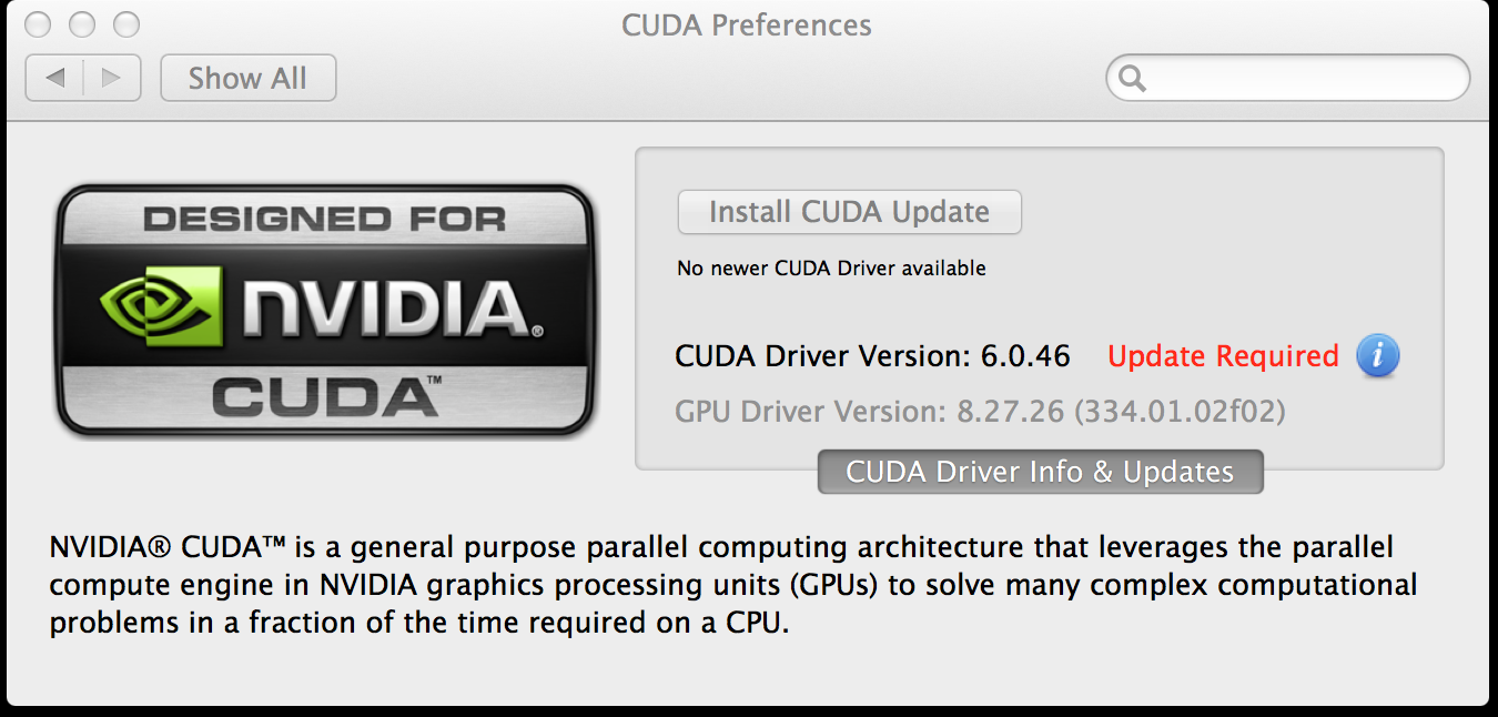

Getting this error. Will we wait for a cuda driver update?
Updated to 10.9.4
installed ModdedWebDriver-334.01.02f02
Updated to 10.9.4
Cardsnk,
Have you noticed any speed increases? Any stability issues? Anything either way? 🙂
-P
Cuda is a separate package on nvidia website, there are 2 installers.
1. The Geforce driver I patched and posted here.
2. The cuda installer that is on the nvidia website here http://www.nvidia.com/object/mac-driver-archive.html it was updated today to match the current driver.
I ask you about this because CUDA+Mavericks never was compatible with 320m, 9400m, 330m and pre-2010 GPUs. Recently, nVidia updated their drivers to support old Mac Pro GPUs, but not the laptop ones I cited above. Would you say your patched driver plus a cuda installer would allow these old gpus to work on Mavericks?
Thank you.
Thank you.
It seem to work on 320m with 10.9.4 on my 13" 2010 MacBook Pro.
I installed Cuda as well and J can run CUDA-Z and have the GPU perform CUDA calculation so I would say yes it can.
