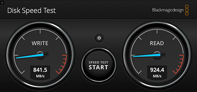

I use a Transcend 512GB SSD Thunderbolt drive which stuck on the back of the stand where it is now my primary boot drive running Catalina OSX.
Runs like a champ - super fast - no more spinning beach ball....

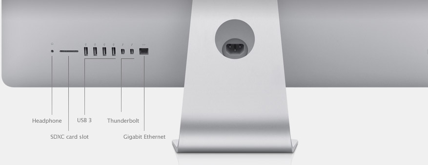

I'm a bit confused. I have a USB 3 hub going into my computer but is the 2013 iMac equipped with USB 3?
Yes your Mac has USB 3 ports.
I now have a 2Tb Samsung T7 as my boot disc using the USB 3 port. Love it. It will do until I am able to replace my iMac. Thanks for all the help!
Reactions: Boyd01
Cool, I have two 2tb T7's for my 2018 Mini and they are great. Very fast, however I don't think the USB ports on your iMac will provide the speed that I get. But when you finally upgrade it will nice to have.
