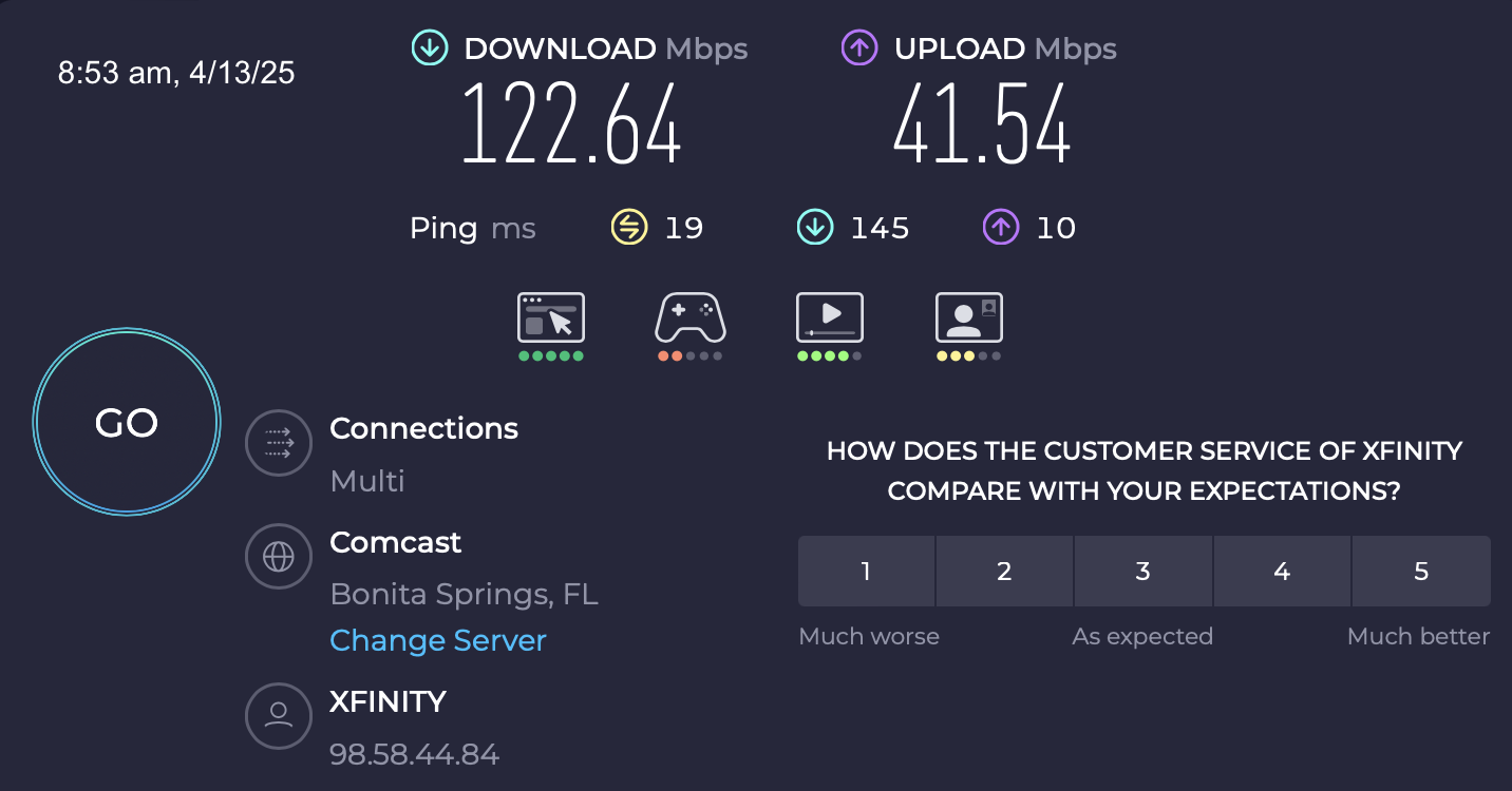

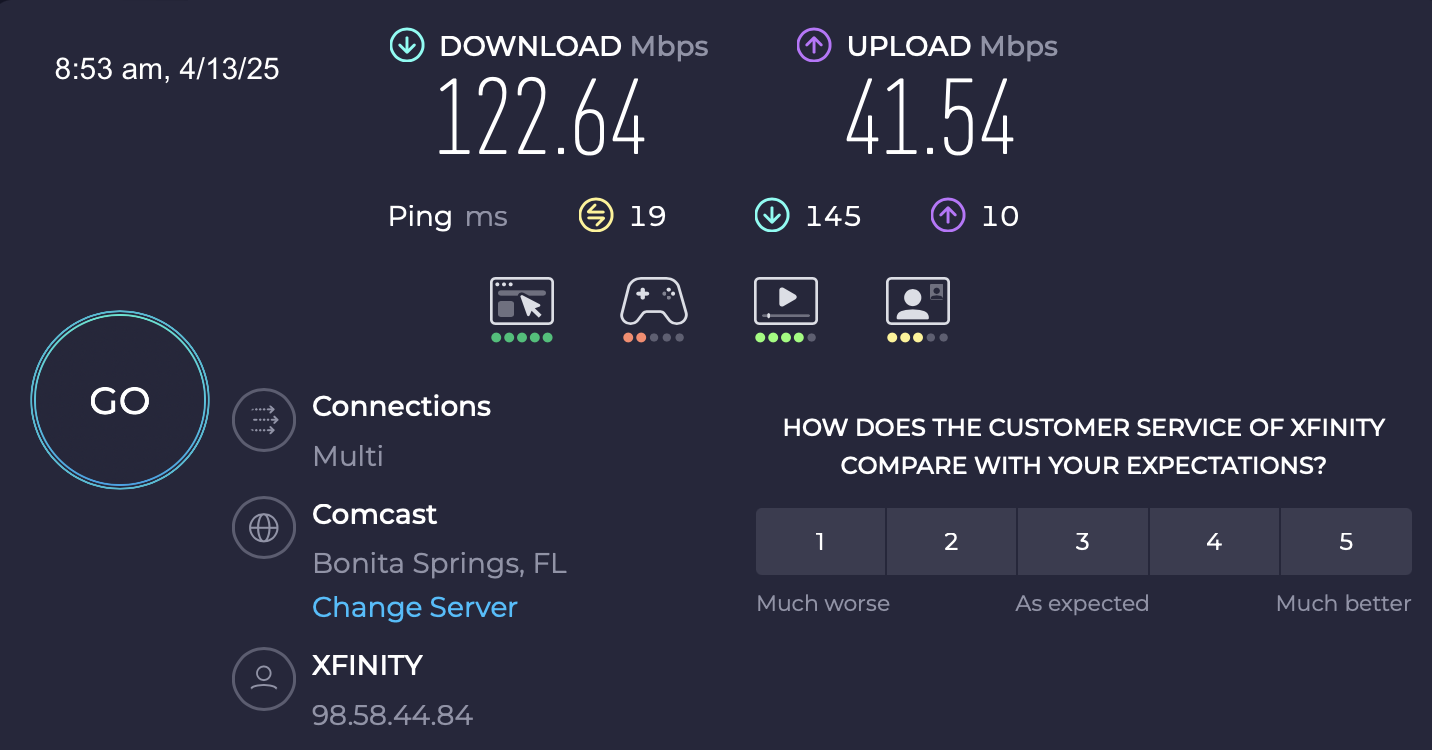

Thanks, all, for the information. I'm paying Comcast for speeds up to 800 but Speedtest.net shows speeds consistently around 100-120/40. How can I improve these speeds? My router is about a year old--Asus RT-AX88u Pro.

Thanks, all, for the information. I'm paying Comcast for speeds up to 800 but Speedtest.net shows speeds consistently around 100-120/40. How can I improve these speeds? My router is about a year old--Asus RT-AX88u Pro.View attachment 2502300
Between the device you are running the speedtest on and your router, are there any hubs or switches? If there are, are these Fast Ethernet or Gigabit-Ethernet? Fast Ethernet tops out at 100. Your speed is limited if your connection goes through any of those.
Also might want to try the website fast.com. It does not have as much overhead to account for as speedtest.net and the speedtest app do.

Thanks, eyoungren. No hubs or switches. Just the cable coming into the house to the modem and then the tether (CAT 6a cable, 3 feet) to my router.
If every device is using WiFi and not ethernet, then the problem isn't the ethernet cable. Your router is getting the full speed.
Your limitation is the speed of your WiFi.
And that's why almost every device in my house is hooked up via an ethernet cable and not WiFi. I pay my ISP for Gigabit speeds. And I have a Gigabit home network. I'm not going to lose out because WiFi is slower than ethernet.

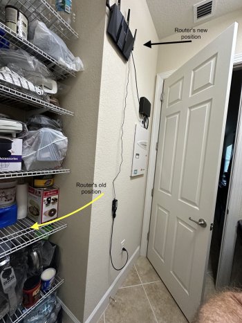

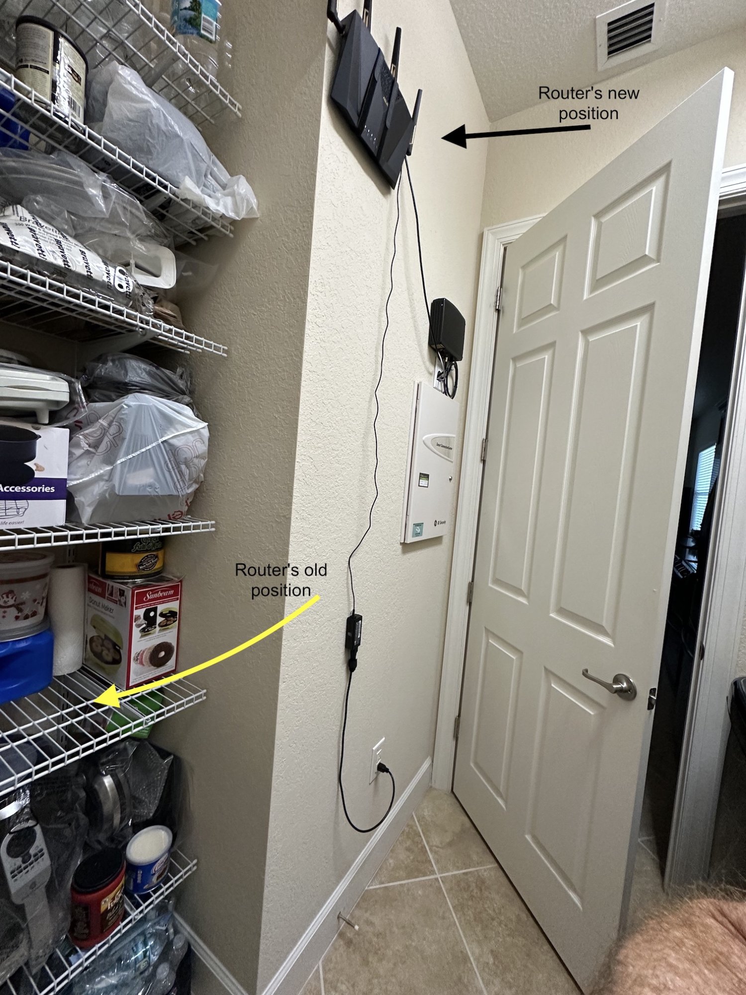

I've relocated the router to a more central location--it's in a small room mounted on a wall now. My router is an Asus RT-AX88u Pro with a strong signal everywhere in my (one-story) house. It would take a lot of climbing around the roof rafters and running ethernet cable to wire everything, so that's not possible.

My opinion only, but that's the wrong place for a router.
(it's in what looks to be a closet, right?)
Seems to me that it should be right out in the open, not next to the wall, in a central room.
