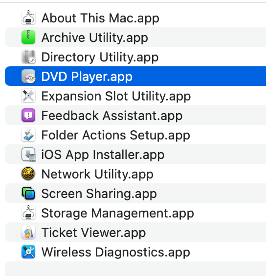

I'm on the Monterey beta 10 and can use the built-in DVD player on a commercial DVD with a superdrive alternative (a cheap Samsung I've had for at least 5 years). I don't use VLC so can't help with that part.
By the way, the location of the DVD player and some other apps is HD > System > Library > CoreServices > Applications. I keep an alias of that folder on my desktop, but some people just put the dvd player app into the dock.

Thanks but I can't find anything like that on this MBA. I did find CoreAnalytics but that's all. Anyway, you got me thinking and I re-accessed whatever media app I reconfigured to make the default operation be: open VLC when inserting a DVD. The way to get access to the actual "content" is to drag the Video_TS folder to the VLC window that says "drag media here" or something like that. Bingo, it plays fine. I still don't know where the DVD/CD preferences are, but I got the VLC to play media there I am.
