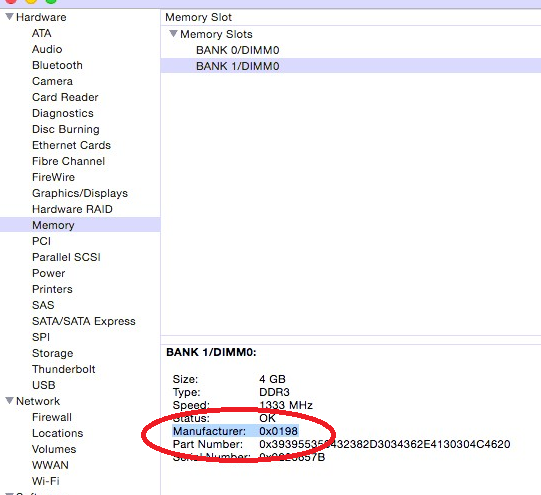

3. I think the best way is to literally take out the RAM and check the numbers on it ... you can try click Apple Menu, then hold Alt and click 'System Information' (this will change 'About this Mac' to 'System Information'). Then if you can go to the 'Memory' option along the left-hand side. The problem is that if you've got a 1333MHz DIMM it'll show as 1067MHz 'speed' due to being underclocked, so there's not a way that I know of, of checking this within the OS (hopefully somebody will have a better idea). Maybe searching the Part Number would help.
4. When going to Apple Menu>Shutdown, ensure the 'reopen windows when logging back in' is unticked.
5. Is this the external HDD that's failing or an internal one? If you have something like Fusion Drive enabled between the SSD/HDD, the HDD failing could be causing a lot of problems ...
Further to the above about the RAM, if you click on each individual DIMM and let me know what each manufacturer is, and the part number as well, I'll try find out for you.
You can Cmd-C, Cmd-V from System Information, so hopefully won't be too inconvenient to get this information. Thanks for your continued patience.

3. Each RAM states in the System Information screen
Type: DDR3
Speed: 1067 MHz
Status: OK
Manufacturer: 0x0198
Part Number: 0x393955353432382D3034372E4130304C4620
But I’ve pulled them all out and they state on them
Kingston KVR1066D357/4G
4. It is already unticked.
5. Smart Utility stated that the OLD Internal Hard Drive was “Failing” apparently.
This is STILL inside the machine and has now been formatted since the last time I posted on here.
