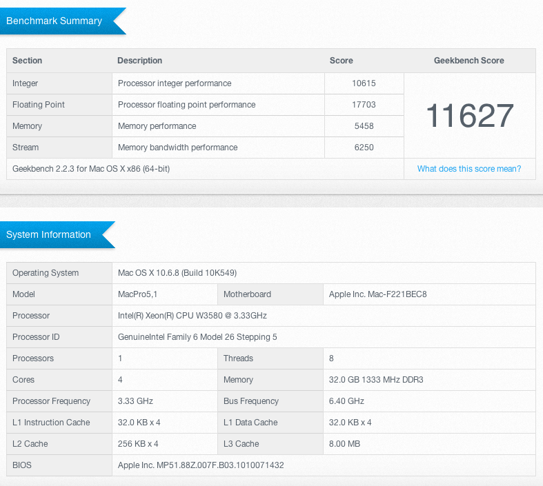

My score went up about 300-400 points from before.
Was a 4,1 3.33 quad with 16GB 1066Mhz RAM, now it's 5,1 3.33 quad with 32GB 1333Mhz RAM.
Maybe I'll swap up from W3580 to W3680 or W3690 someday.

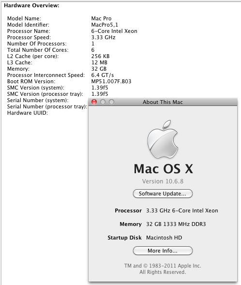

Just got my W3680 in the mail. Off to the store for some Arctic Silver 5, Goof-Off and spudgers! So excited right now.
wonderspark
macrumors 68040
Feb 4, 2010
3,048
102
Oregon
Had to go buy a 3mm long hex tool kit when I found out mine was too short, haha.
Anyway, I'm a happy camper! So far, it's running about 6 deg F cooler than the W3580 did.
