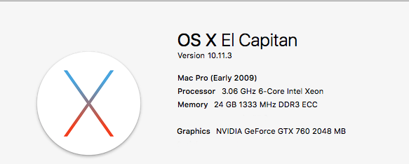

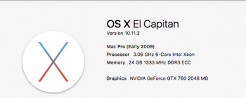

Update: EVGA GTX 760 installed. Thank you all for your advice, input, etc. Greatly appreciated and valued. Cheers!
