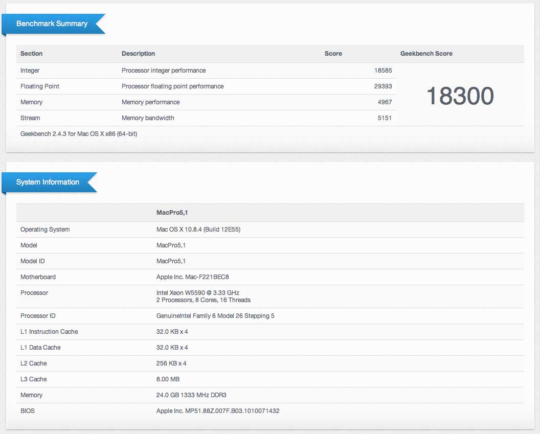

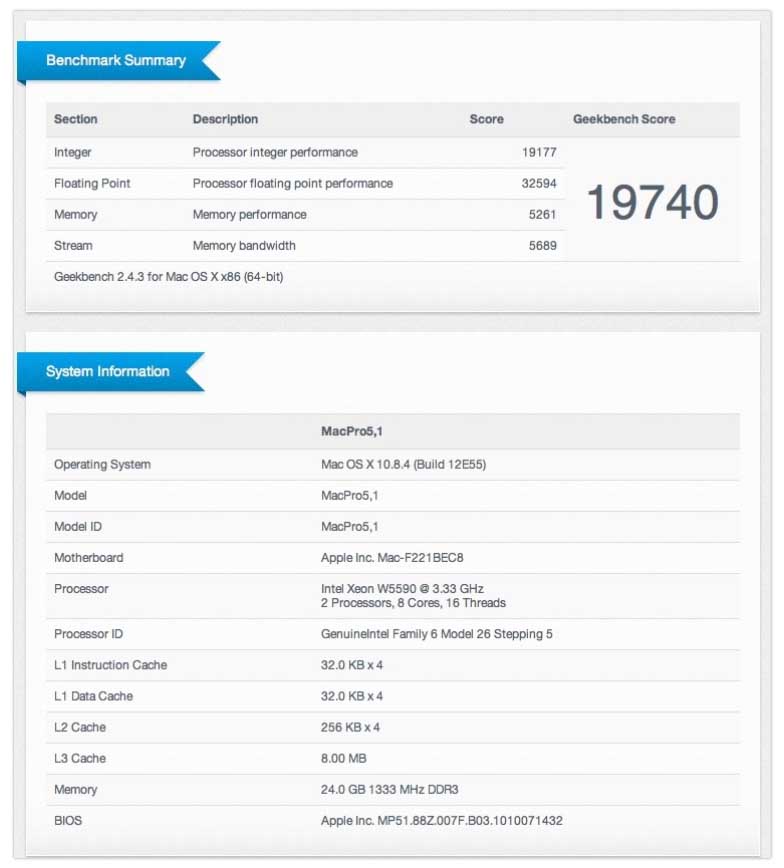

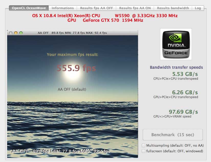

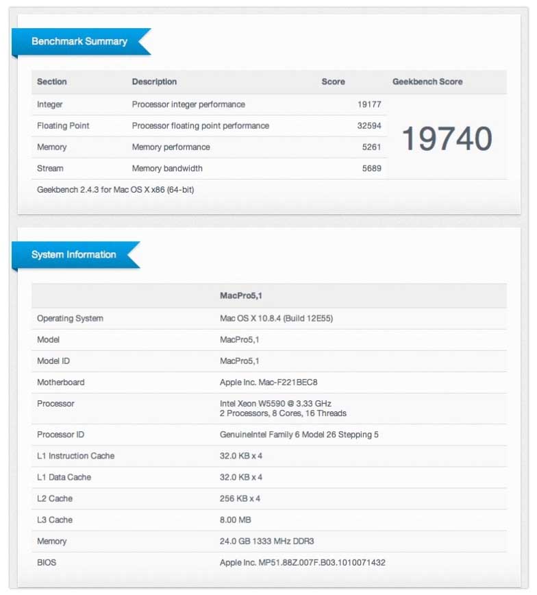

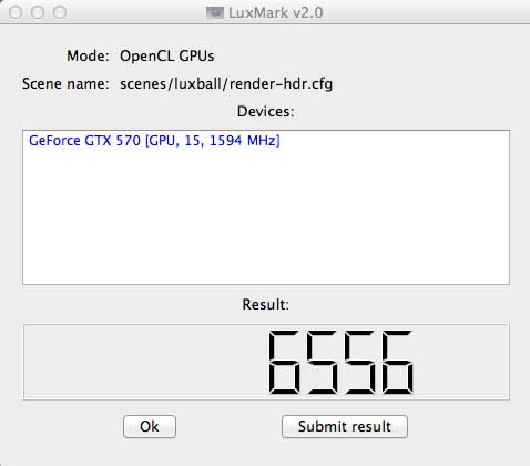

Hi Kenny
Since my last post I have received and installed my W5590 CPUs. I have discovered, among other things, that Geekbench shows a higher score in OS 10.7.5 than in OS 10.8.4. IIRC, I recall reading in the past that arond the time of the release of 10.8.3, something in the OS changed the Geekbench readings. As far as your GTX580, yes IMO, 85°C does seem too hot. I know a lot of the temps in my Mac, but not the GPU. Are you running smcFanControl? I am, and I upped the speed of my Mac fans slightly to compensate for the higher TDP of the new CPUs.
I am attaching various benchmarks that I am getting {both Geekbench scores (10.8.4 Vs. 10.7.5)} LuxMark (the scene you ran) and OceanWave. If you recall, my video card is an overclocked Gigabyte 3 fan GTX570 with an EFI flashed by MacVidCards. My three fan card is very quiet. The Mac makes a little more noise now, since I sped up fans. Nothing objectionable though.
Lou

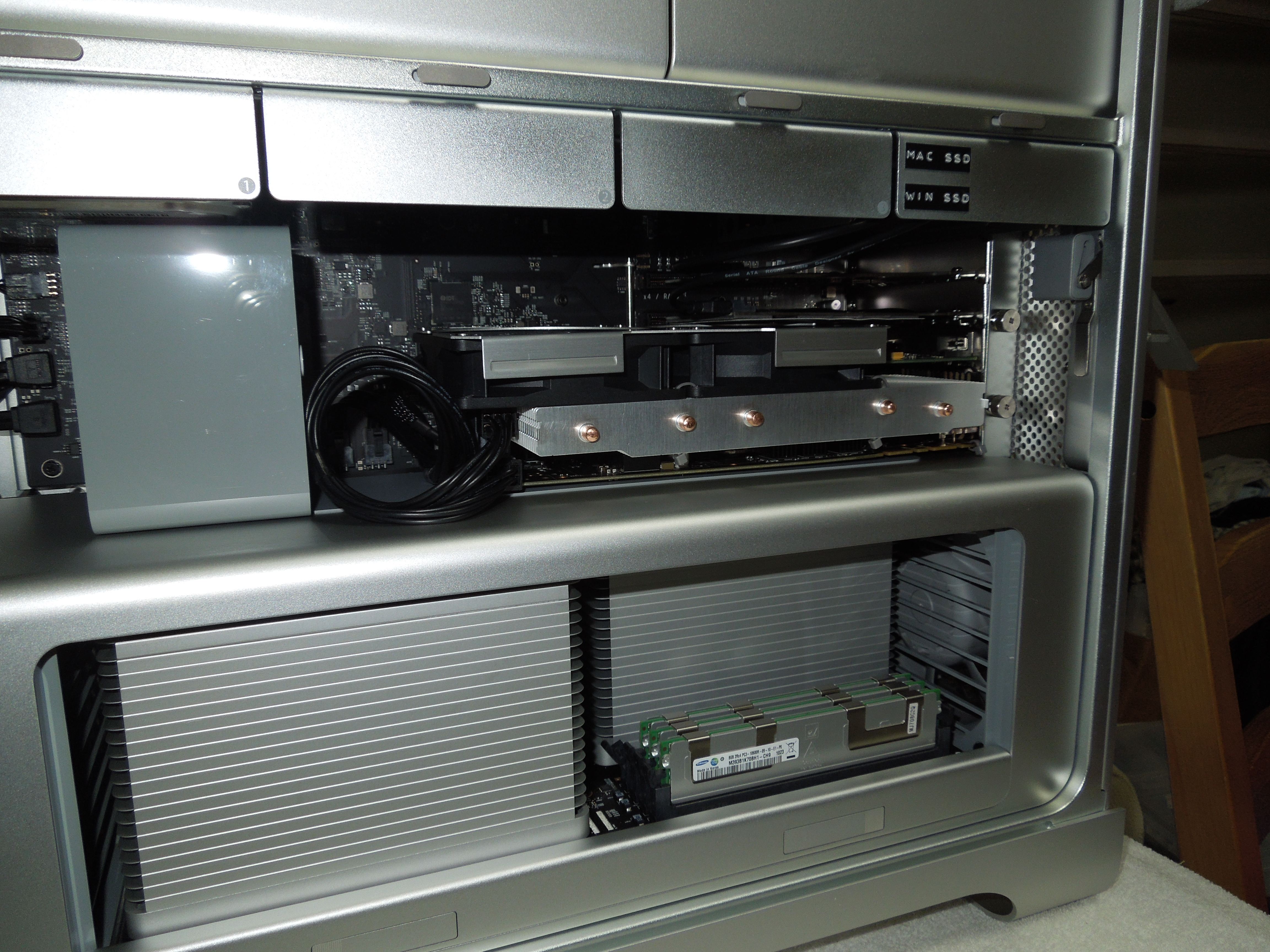

Update on my situation, my GTX 580 was overheating and shutting down my mac, so I took it to the nearby computer repair shop for a quick check. Apparently it looks like all the screws including the ones around the heat-sink are loosed and worn-out, no good contact between the card and heat-sink, hence it was overheating.
I am now looking for a third party GPU cooler that will fit my case (as I want the remaining 3 PCIe slots accessible for use. But I cannot find one with the same height. I can see only 2.5 or 3 pci slots heat sinks...I am stuck, will try to look for an old GPU and remove the cooling parts, will have to do some modding.

I exceeded the return period (only eligible for 48 hours for full refund). I had to figure out how to lower the temp. So I searched around and found an old GTX 470 heatsink and did some modding to install 2 fans. I also bought a cheap GPU cooler for parts, I have put it together...will be running some tests in the coming days.
http://postimg.org/image/wsffsji4h/

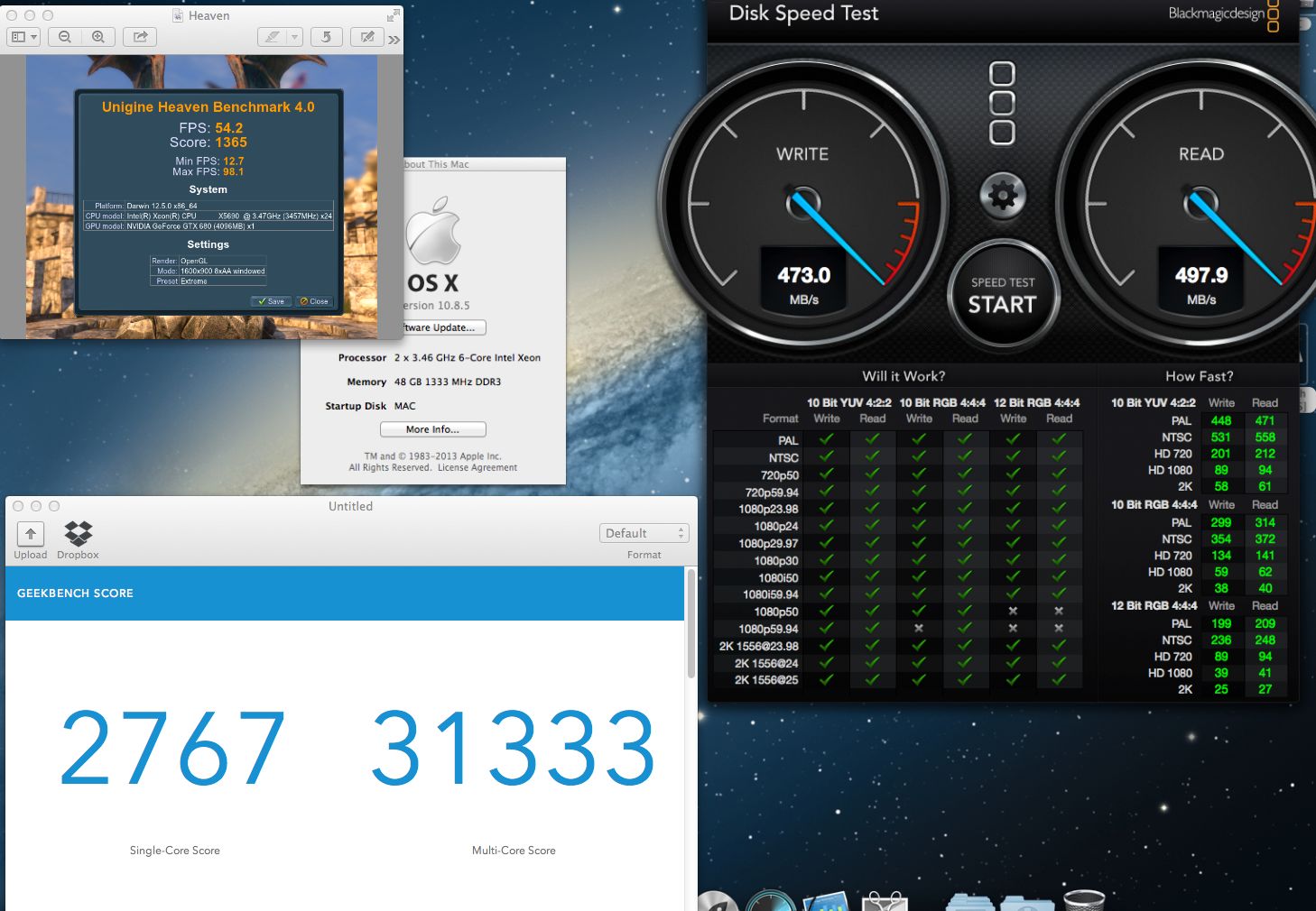

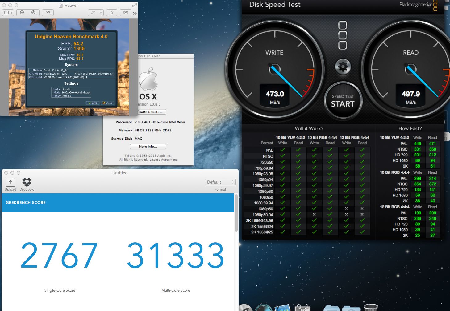

MP 5,1 upgrades completed!
Just want to update my post, I had some time over the weekend, so I did my mac upgrade. Added 2 x SATA 3.0 card on PCIe + 2 SSDs and finally replace my old 9800 with a GTX 680. Every thing looks good so far, booting Windows and ML without any problem, GPU temperature is also nice with a custom GPU cooler😛
I am now looking into purchasing a 3TB drive by end of the year. Right now I have couple of sata ports free;
2 x SATA 3.0
3 x SATA 2.0
A nice 31xxx score over geekbench, which I do not really care about, but not too shabby for a 3 years old Mac😀

Beast of a machine you got there🙂 I installed a 3.46 hex in my single cpu .. should of went dual lol. I dont see your sata cards.. I might want to install one for a ssd for windows install. Which one are you using ?
I am using sata pcie card, I bought my card from ebay. It is little old now, I saw new ones with new Marvell chips. Just check ebay😉
Just want to clarify on this post, I mean mine does not have a brand (nothing on the card). I received it in bubble wrap and bought it from ebay.
