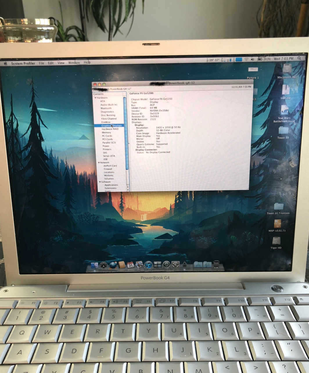

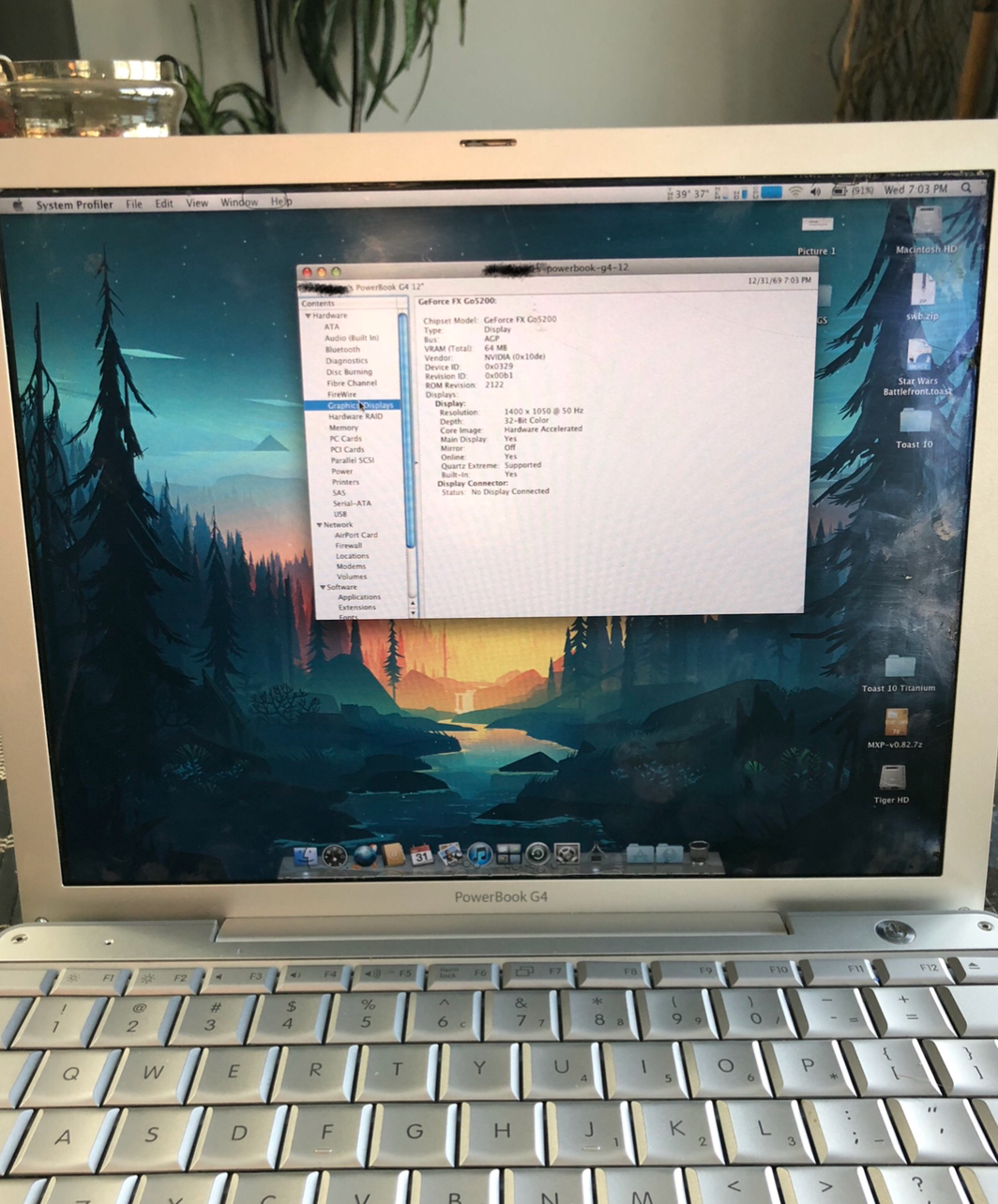

For a while now, I've had a PowerBook G4 12". I love the form factor of the machine, and would love to start using it as a main computer in school. But I would like to perform a few upgrades to it, and one of those upgrades would be the replacing the LCD with a higher resolution one.
I found this guide on iFixit, https://www.ifixit.com/Guide/PowerBook+G4+Aluminum+12-Inch+1-1.5+GHz+LCD+panel+upgrade/3117
It goes over the process of replacing the LCD with a 1400x1050 HV121P01-100(or 101) LCD, The guide seems pretty simple, just need to make the new screen fit in place and you're golden.
Has anyone else actually tried this though? I'm curious how the Go5200 performs with the extra resolution, and how the screen looks compared to the old one(brightness/colors/etc). I attached an image from the guide that shows the screen in use.
Thanks

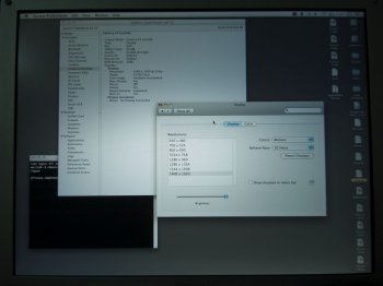

The LCD itself in a 12" Powerbook is pretty easy to replace. I replaced mine due to it being dim. I think the hard part would be soldering the wires depending on your experience doing such a thing. I don't know if my poor eyes could handle even smaller type. Looks like a cool project though.
Indeed it seems to be, and very nice! And I believe the only soldering I need to do is extending the 'CCFL High Voltage' cable, which I've done soldering like that so its fine(you could probably get away with just twisting to wires together and putting heat shrink over it but for a LCD I wouldn't attempt that). and I would think Mac OS X has some settings to upscale the UI if its unreadable, I'll look around 10.5.

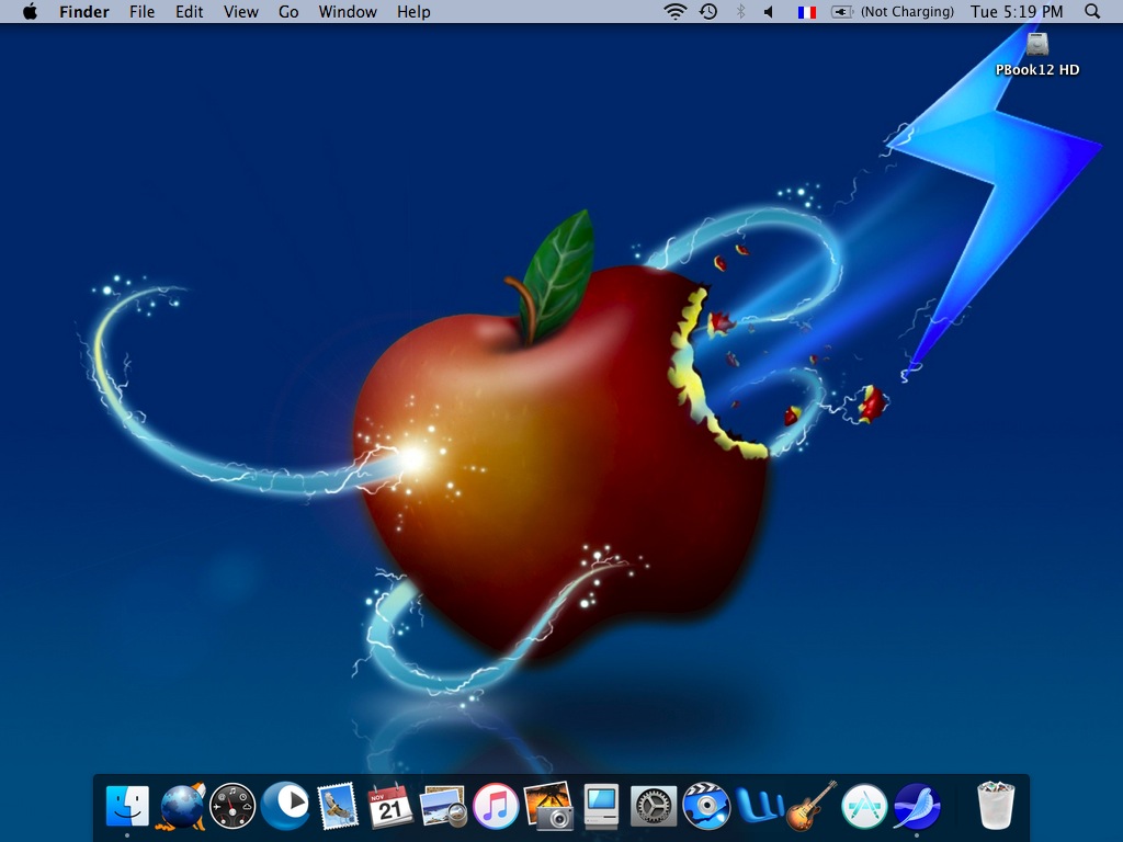

I put one of these hi-res screens in a 12" powerbook that had a broken panel. The extra resolution is nice in "portable" mode but at a desk I still use an external monitor. Also, the screen I got is not particularly bright. This might just be luck of the draw, but I see that there are some LED kits available to replace the arc lights. I would be interested in doing this if anyone has experience or info on hooking up the LED strip to the powerbook.
