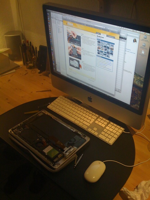

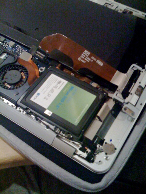

Well, I also did it. I bought the MTRON MOBI from the same guy in Ebay than fan9 did. Yesterday it arrived (from Korea!)... At the evening I intalled the MTRON drive in the Macbook Air.
The computer feels snappier now, I thought I could give you some info about the time the computer needs to start applications:

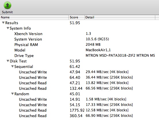

is there anyway i could persuade you to download xBench and give us your scores with the MOBI installed? :D
X-Bench scores
awesome!
As you wish, here they are:

Great contribution, Kikote!. I see the Xbench results shows Read @ 66MB/s and write at ~ 37MB/s, this is not bad considering the price. Actually, a bit faster than the SSD in Rev A, as I recall its read is about 60MB/s.
