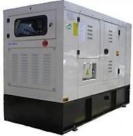

True. There's bigger, then there's BIGGER. 🙂
30KW: 😎
