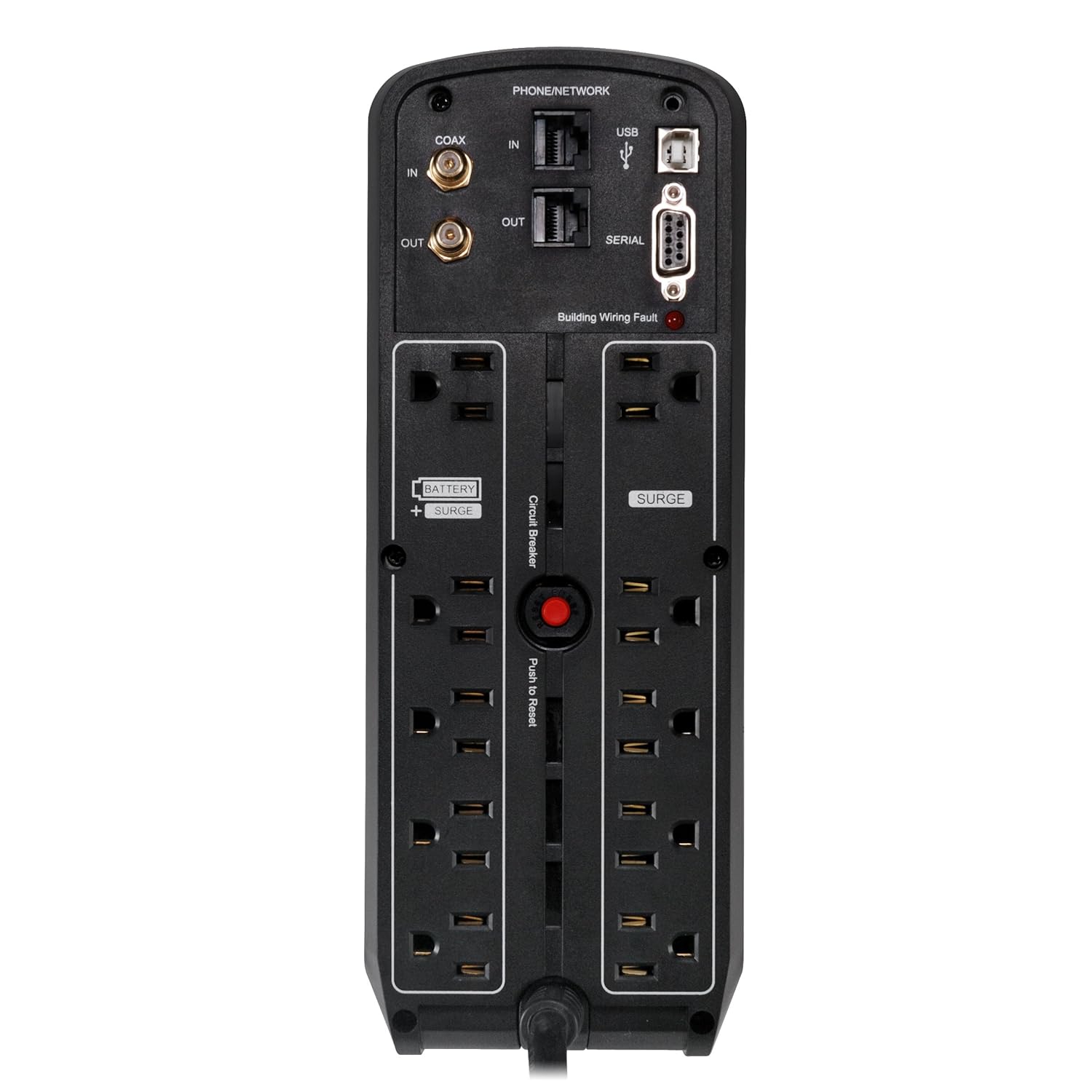

Surf the Amazon.com URLs (see above posts).
re: http://www.amazon.com/CyberPower-CP...?s=electronics&ie=UTF8&qid=1331150651&sr=1-13
Below the Backup UPS picture is lots of little pictures, Click on those little pictures.
re: http://ecx.images-amazon.com/images/I/81J0KwV4s8L._AA1500_.jpg
Top right corner shows USB port - for control cable.
