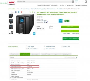

Cyberpower ups’s are ‘pure sinewave’

As posted above, many CyberPower are pure sine wave models. Using 1500PFCLCD and 1000PFCLCD for different purposes. I highly recommend CyberPower. Have had fewer long-term issues vs. some other big names.

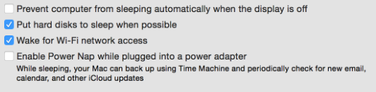

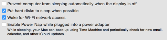

Don't they spin down on their own when not in use? My hard drives are external with their own power adapters and they spin down when not in use for some period of time. This happens even if the computer is on, and definitely when the computer is off.
You might check this hard drive setting:

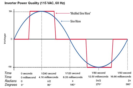

Modern high efficiency PSUs like sine waves...
https://dl4jz3rbrsfum.cloudfront.net/documents/CyberPower_Active_PFC_Solutions.pdf
"Shutdown can occur because simulated sine wave output has a power gap in each cycle. When the UPS system switches to battery current, a power supply with an Active PFC circuit may detect that power gap and shut itself down."​
https://www.dougv.com/2010/03/active-pfc-enabled-psus-are-not-compatable-with-most-low-end-ups/

The cheaper ones us a "Stepped approximation to a sinewave" - which is smoother than the square wave. The more steps, the closer the approximation. An infinite number of steps would give you a sine wave.
Which model APC?
