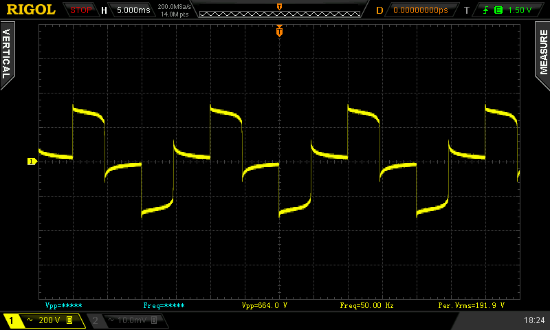

No such thing as a pure sine wave. This UPS was marketed as a sine wave UPS. It outputs 200 volt square waves with a spike of up to 270 volts. They did not lie. We all learned it in high school math. Square waves and spikes are only a sum of pure sine waves. Pure sine wave does not exist. Honesty recommendation demands numbers such as %THD.
One did not know which UPS has a high or low %THD. A conclusion is only relevant to that UPS with that computer. It says nothing useful here for anyone else.
No relationship exists between a pure sine wave output and drop that might occur when the UPS responds to noise or voltage changes on AC mains. That drop can occur with a pure or non-pure sine wave UPS. And can occur with some model UPS from any manufacturer.
No hardware damage was created by 'dirty' UPS power. And that is the point. Pure sine wave UPS is promoted to protect hardware. Even the OP admits operating on a not-pure UPS for four years without damage. Hardware is perfectly fine (unharmed) even with 'dirty' power. At worse, 'dirtiest' power only means a computer (with high PF correction) does not power on. Nothing more.

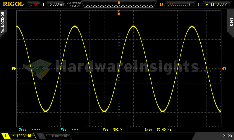

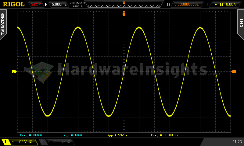

Some UPSs that have been tested to produce a pretty good sine wave:
Demonstrated by that citation are so many 'dirty' UPS outputs. And again the point - which is not about a few UPSes with cleaner outputs. Relevant fact:

Wow - when presented with evidence that destroys your argument you claim that it supports your argument.
Dirty UPS:
Sine-wave UPS (the APC 1500 that I recommended):
You continue to claim "square waves with 270volt spikes" when these "oscilloscope" graphs show very nice approximations of a sine wave without any spikes.
Of course, you are technically correct that there are no "perfect sine waves", there will be some THD in any device. However, the output from the APC 1500 in the second chart is close enough to "pure" that the pixilation of the jpeg is more than the deviation from "pure".
