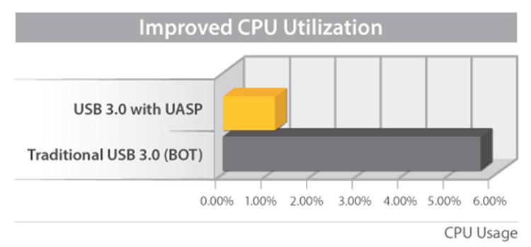

This is what UASP helps for. It is only available for USB 3 and above, though.
