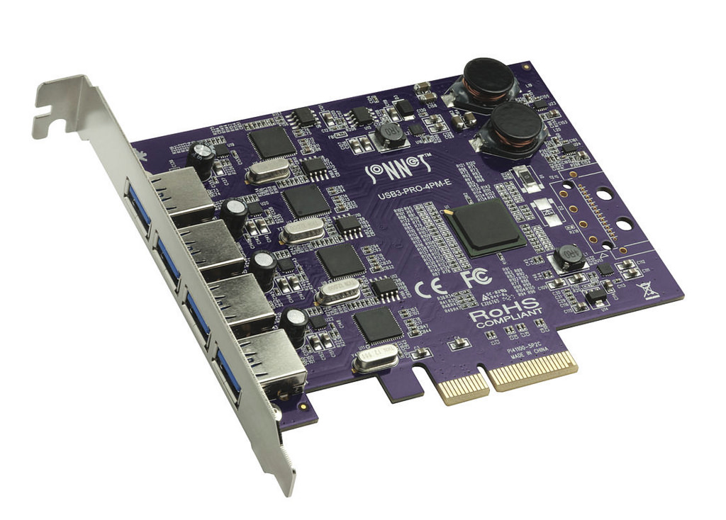

I will be purchasing a Sonnet Allegro Pro (USB3-PRO-4PM-E) 4-Port USB 3.0 PCI Express Card very soon....
Just got mine today. This card is awesome.
Using two 64GB Kingston HyperX USB flash drives I was simultaneously transferring at 600MB/s (300MB/s from each stick) to an XP941 SSD and it didn't flinch!
