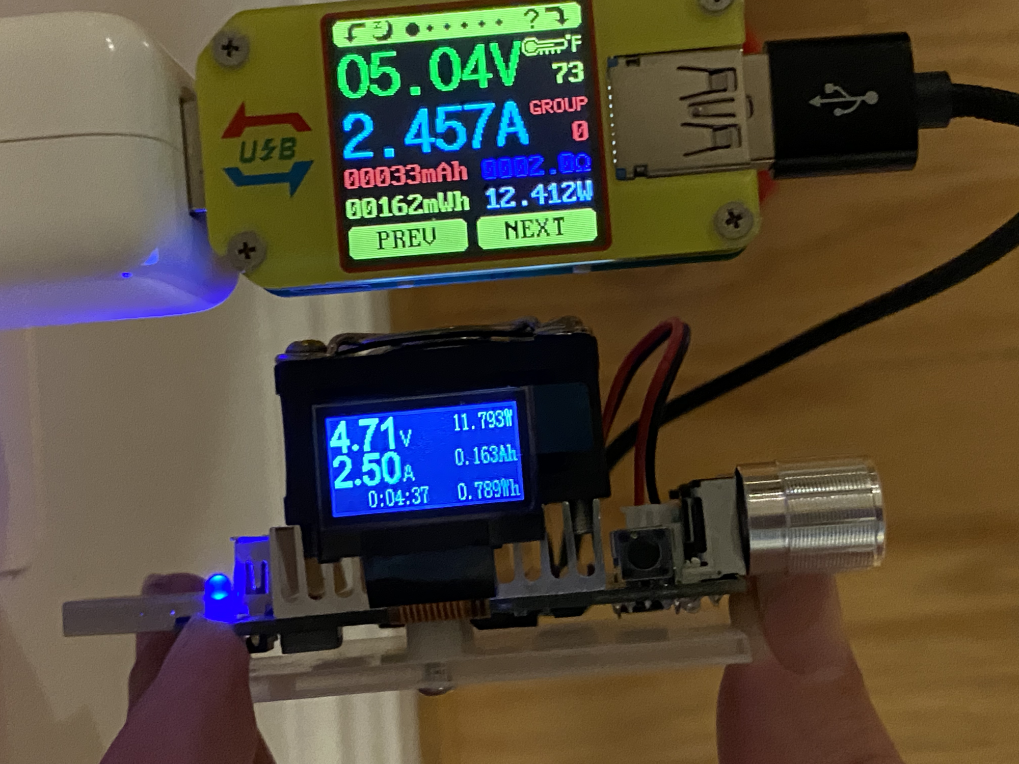

This is close as I could get for you. 12 watt USB A Apple charger going through a USB A to USB C cable. Its the shortest I had, 8" (least resistance).
Even that short 8" USB A to USB C has too much resistance to get 12 watts. Voltage has dropped below USB spec acceptable limits at 4.71vdc. If I increase the load by even a faction of an amp higher the power supply trips off on its safeguards.
I think with a USB C using a USB C to A adapter on the charger the results would have been a tad bit better.

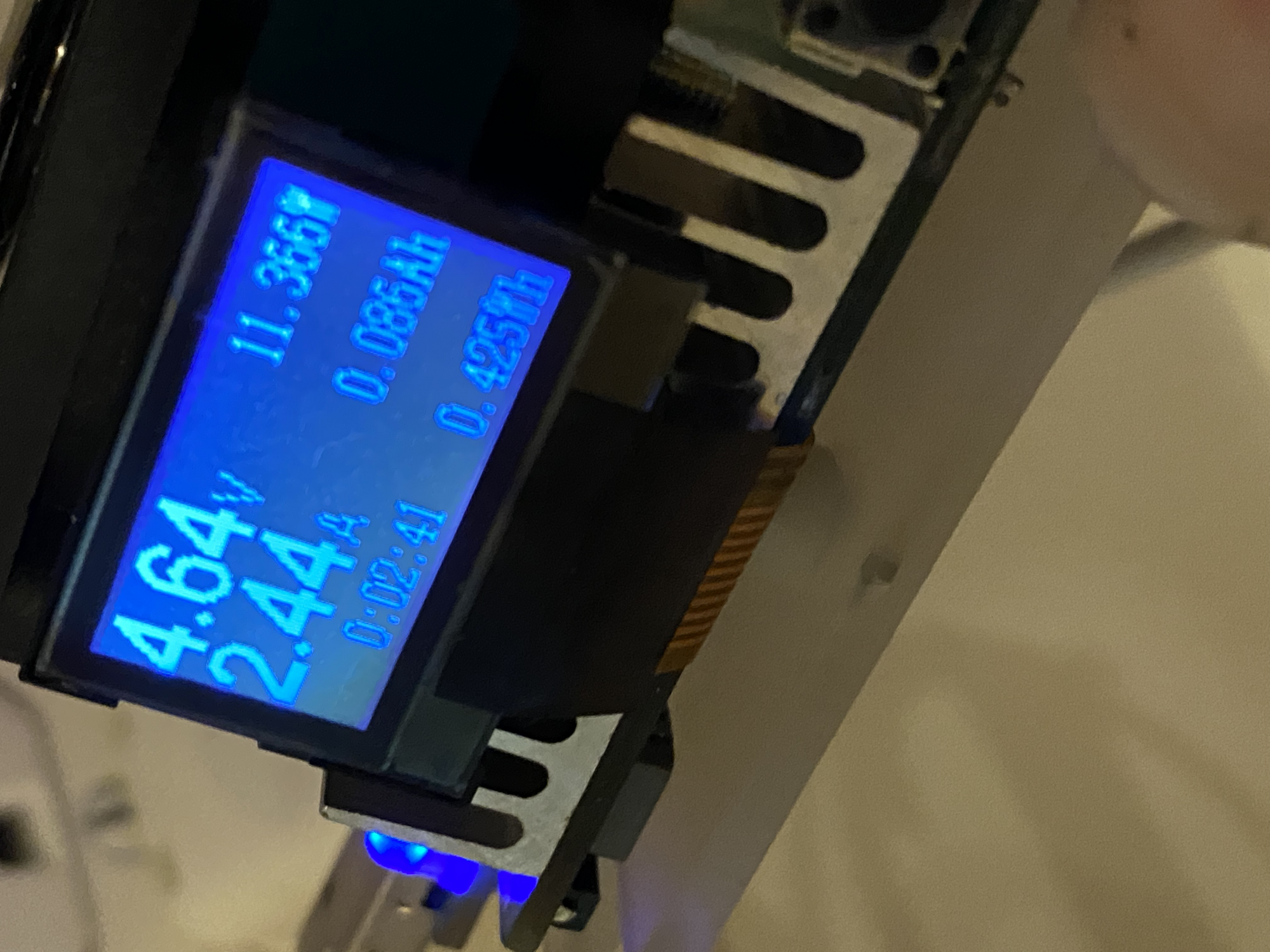

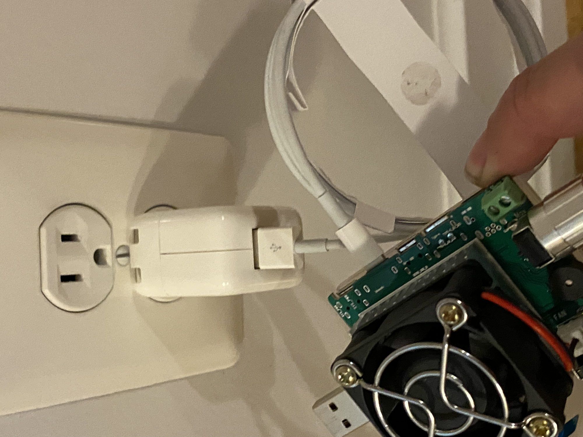

You might find this interesting. We know that 12 watt power supply is doing as it advertises from the above pic.
BRAND NEW APPLE Lightning cable can deliver around 10 watts max, trying to increase the load again to get as close as I could to 12 watts only gets me to 11.3 watt and WELL below 5 volt we need.
Moral of the story....volts x amps = watts. When you restrict the voltage to 5 vdc the only way to increase watts is to increase amps. And higher amps at a low voltage makes the requirements for the cable (to minimize all the resistance you can) just too unrealistic.
