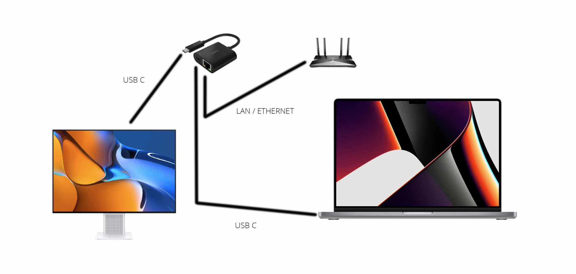

Hi, is is possible to connect USB C ethernet adapter to external monitor and than connect it to my MBP M1 pro so that it feeds internet and power with one usb C cable? Hope it is not too confusing. See pic attached. Thanks!

Yes it's easy to do, but your diagram is wrong. The MacBook plugs into the monitor, not into the adaptor. All you need is a monitor with a USB hub, doesn't matter if it's normal USB or USB-C.

The advantage of USBC is that it can carry USB & picture & power all in one, so with the right monitor the MacBook only needs a single cable connected to get power & picture & USB. Not all monitors can do this though, and it tends to be expensive, especially monitors that can deliver enough power through USBC to charge the MacBook.
