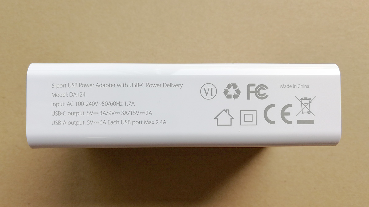

Here's a picture of the charger I have in mind. It's a DODOCOOL DA124. It supports USB-C PD
So that charger seems to support output of 27w charging. It's my understanding that the X/8 can take a peak charge of 15w, so you should be good to go.

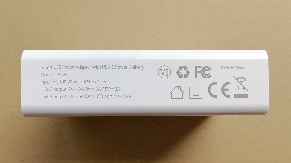

Not sure how to read the specs for the charger I'm interested in buying above. It reads
5V==3A/9V==3A/15V==2A for USB-C output.
The fastest speed is actually 18w (lot's of mis information in this thread) you need something that can do 9v at 2amp to achieve that, which isn't this charger. This will do 14.5v at 1amp like Apple's 29w charger (yes the spec on the charger says it can go up to 14.5v at 2amp but it DOESN'T this is too much for the small battery) so the official charger and this one will do 15w.
The 60w and 87w charges will do 18w (or just slightly under) so they are the fastest, but Ankers 29w chargers will also do 9v at 2amp (which Apple's can't) and thus will also do 18w.
