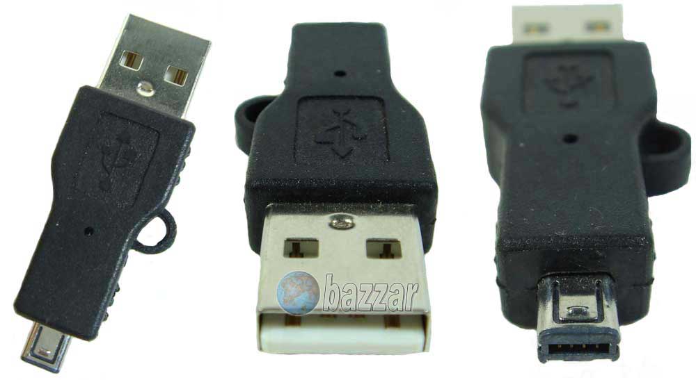

$4.00
That is a DV capture device that does not give you access to the original footage. There are no FireWire/USB protocol converters.
I don't think there are any, sorry, ...cept for swapping yours for a whitebook or MBP ?
It's that face palm thing again....those wont work kastenbrust.... I should do a double facepalm but I wont.
