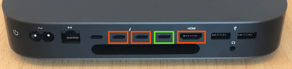

Suddenly my 3rd monitor stopped working, and all the ports on the USB-VGA converter went 'wonk' . . . thought it was the converter. Anyway, after a lot of pissing about it turns out that the port marked in green on the back of the Mac Mini seems to be 'dead', and I am able to get the 3 video signals out of the ports marked in orange (which the official Apple documentation says is not possible) . . .
But you’ve highlighted only 3 of the 4 TB3 ports and with the HDMI cable.
Have you done a hardware diagnostic or just have the problematic USB-C port connected to your adapter and this external screen?
What official Apple documentation?
As far as I know, you can connect two displays to any one (using a Thunderbolt dock or adapter or device) or two Thunderbolt 3 ports, and a third display to the HDMI port.
No, I have done no hardware diagnostic as I do not know how to I am: I am an EFL teacher and educational programmer, not a whizz with machines. 😎
Of course, if you want to be a "nice person" you could let me know how to do a diagnostic.
All four Thunderbolt 3 ports function the same and have identical capabilities. All four will drive video.
If that one port does not drive video anymore, you need to get the machine serviced. Assuming you are in a location where the Apple Stores are closed due to COVID-19, I suggest you contact Apple Support (online, phone) and have them start a repair ticket now. When the stores reopen, you can take it in.
If you haven't already done so, you should try different cables in the suspect port. Cables can go bad too.
