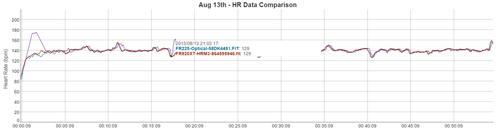

You only need to look to sites that review fitness devices seriously to see where the AW falls down for fitness tracking. The AW sensor is not as accurate, nor does it update as quickly as other good wrist-based devices, let alone a good chest strap. Your opinion that it is every bit as good as a high-end Polar is the one way outside the norm, and would need to be backed up with some solid data. It could be that your standards are different, or that the bit of data that you are basing your opinion on is simply a fluke. The information I have seen from Consumer Reports tests merely stated that 'there were no significant differences'. Well, where are the graphs? What constitutes 'significant'?
This site knows how to review this kind of gear. Here are some graphs from the Garmin 225 review http://www.dcrainmaker.com/2015/08/garmin-forerunner-225-depth-review.html that illustrate how the AW falls short of other wrist based monitors, let alone chest straps. AW is in purple.
So maybe that is 'good enough' for you, but the data doesn't lie - the AW simply isn't as fast or as accurate as competing devices.
I have run extensively with the Garmin 225 for the last year, and with the AW for the last month, and my experiences match the data above. These graphs represent the type of difference I see routinely. The AW simply fails to get a reading during long periods of time, and if I want real time updates I'm left staring at my watch waiting rather than watching where I'm going.
Apple Watch.

The thing is, no-one serious about running would trust any of these devices.
Heart rate? you can't even trust that, there are so many different factors that could influence it that it becomes another nonsense slice of data.
Trust verified distance, a decent stop watch, a pen and paper and if you are particularly geeky a spreadsheet to analyse the data in the way that suits you.
LOL. What? Good watches track good chest monitors very closely. I can guarantee you there are tons of serious runners using that data. You are talking to one right now.
sent back my garmin 630 today, Like it a lot but couldn't justify the cost when i have the fenix 3 in the drawer next to my AW.
I assume he means the Apple watches. That is the one device a serious runner could not count on as a serious device when compared again devices like Garmin/Fenix.

As an owner of an AW1, I'd just wait and use your fitbit. I am not a total fitness data nerd like others on this thread are so as long as it is kind of accurate, I am okay, but the reason why I wouldn't recommend it at this point is that a lot of the running apps are just plain glitchy. I run with my phone so some of the issues with distance accuracy don't really apply to me, but every time my Runkeeper app updates on my phone, it glitches on my watch and I end up having to delete it and reload it on the watch, which is really annoying. It either doesn't record my heart rate, or the running data doesn't stay on the screen etc....
That wasn't the case with Apple's Workout app under OS1. If it's true, it may have come as a later update. But my experience (and recollection) is that third party apps used the phones GPS right from the start.
This is a complex answer. The Apple workout app does seem to be involved with GPS data to calibrate stride length, and this seems to affect distance calculated by the Workout app when the phone is present. Also, from day 1, apps like Runkeeper would "use" GPS, but that was a loose term. What RK did was simply act as a remote interface to the phone app. So, the watch was not really using phone GPS data with the 3rd party app.
Even today, I think this is still the case. Workout only uses GPS to refine calibration, and RK and the others are just remote iPhone app interfaces. Though the newest fitness apps can act in two modes-- connected to the phone and disconnected. Early on, the apps could only function in a connected mode. But, the use of GPS is essentially the same as before.
Reactions: PatrickNSF
Personally if it was me I'd wait for AW2 I wouldn't even buy a cheap band. before the AW I was using various apps on my iPhone comparing what I was doing on my iPhone and then when I got my AW the stats weren't out massively.
Obviously there is a lot to consider on what my iPhone can measure compared to the AW, but if you're willing to wait I would.
