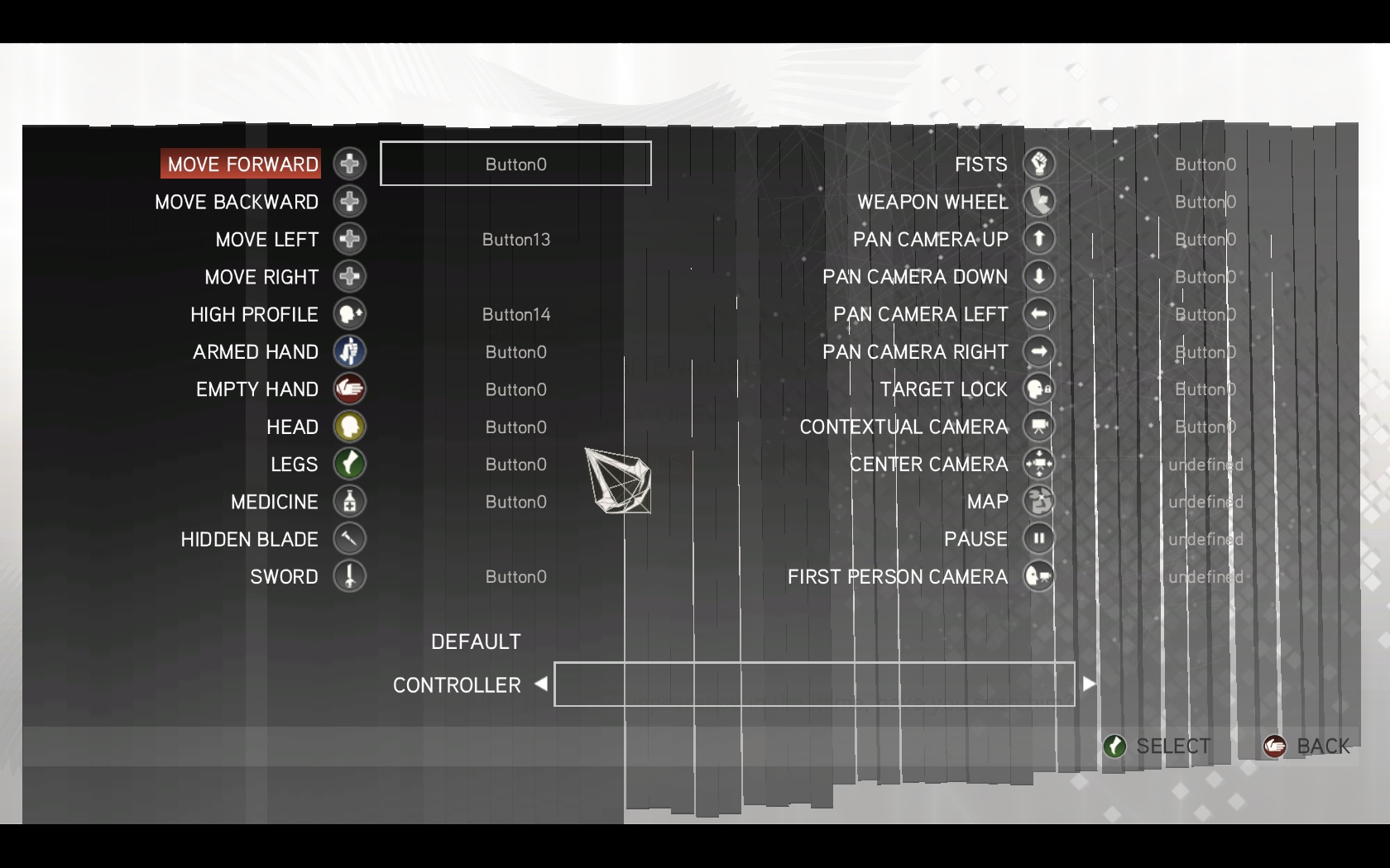

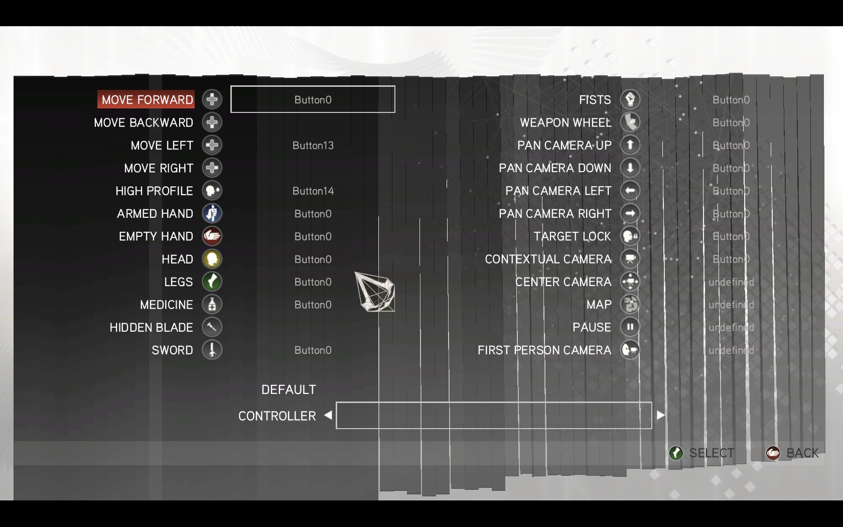

Wii Remote Alternative?
This is probably off topic considering the 360 thread title, however pertinent considering the problems.
I've been trying without success to get my 360 controller to work with AC2 as well without success. Mainly because the game only thinks it necessary to give us symbols instead of the actual button letter like any other game (i.e. Press 'kick' instead of Press 'space' or whatever). I desperately want to like this game but every control I don't know feels like a homework assignment; it's like 'press :rolleyes:, ok which key does :rolleyes: correspond to? Press escape, go to controls, oh, that button, resume game.
Anyway, since the buttons are color coded I figured the 360 controller would make things easier but surprise surprise, no support. I even went so far as to ask Ubisoft if it was possible but they essentially stated that since the game was so old it was unlikely they would put any effort into it and that no controls beyond the mac keyboard and mouse were supported.
So anyhow, I realized this was bs when I was at least able to get the game to respond to inputs from the 360 controller by tweaking my Assassin2.ini file and adding a new input by hand. Read: The program will respond to control pads, but it has no idea what it's doing. I just have to figure out which button is which.
This has been surprisingly easier when on a whim I downloaded the wiimote drivers from WJoy, paired one of my wiimotes (along with a classic controller) and badda bing, badda boom. Assassin's Creed 2 seems to love it. It can't seem to enumerate the buttons worth a crap, but it definitely recognizes them since I can now navigate the game using the Classic Controller's d-pad and ABXY buttons. To see what I mean, check out the included screenshot and code from my Assassin2.ini file (located in ~/Library/Application Support/UBI-MAC-001-WW/)
Not saying this will work for everyone, but it just proves Ubisoft is pathetic at customer support since the game obviously supports controllers with simple additions to the configuration files.

I still get a stupid bug that if i plug and unplug the controller a few times it kills all my USB on my Mac Pro :(
Sounds like you still have the old drivers installed. I had that a while back (0.08 or 0.09?) but I have not seen it in the latest versions.
Edwin
