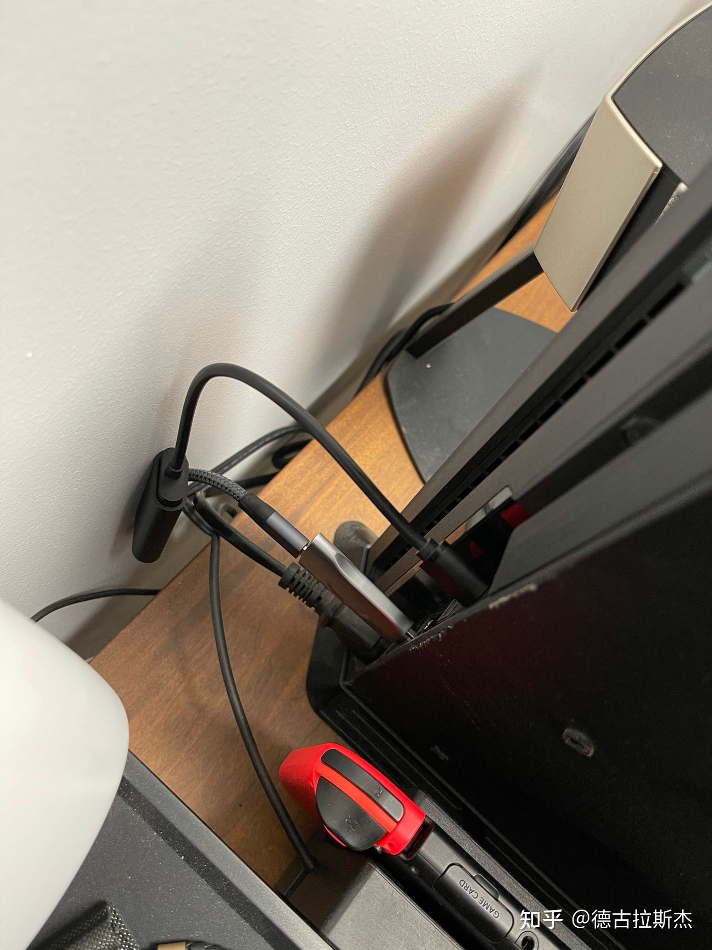

Because of the aging of your HDMI output device insufficient power supply for the chip in the cable. You only need to plug that USB-A into the USB port with a 5V usb power output will be fine. I also had this problem at the beginning. I try the SIIG a and other similar adapter long time ago it do not support 4K and sound. It is design for VR display I guess. The ebay seller they have a upgraded adapter I also bought one today it work perfect on 4k and they support TB3 and HDR now.

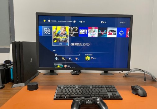

PS4 pro HDMI--> LG Ultrafine 4k 23 TB3 port
PS4 pro HDMI--> LG 5K 34WK95U TB3 port transmit HDR OK
Laptop Dell G3 HDMI--> LG 5K 34WK95U TB3 port
Laptop Dell G3 HDMI--> LG Ultrafine 4k 23 TB3 port
use this adapter, link for details
I have bought this and seems to work well, however can only get 1080p from my PS4 Pro to 5K Ultrafine. Do you know if 4K is possible?
Yes, it's support 4k for sure.You may need some settings. If your ultrafine show that the default resolution is set to 1080P, you can enforce select 4K on PS4 pro and then ignore the warn click yes it should be fine.
