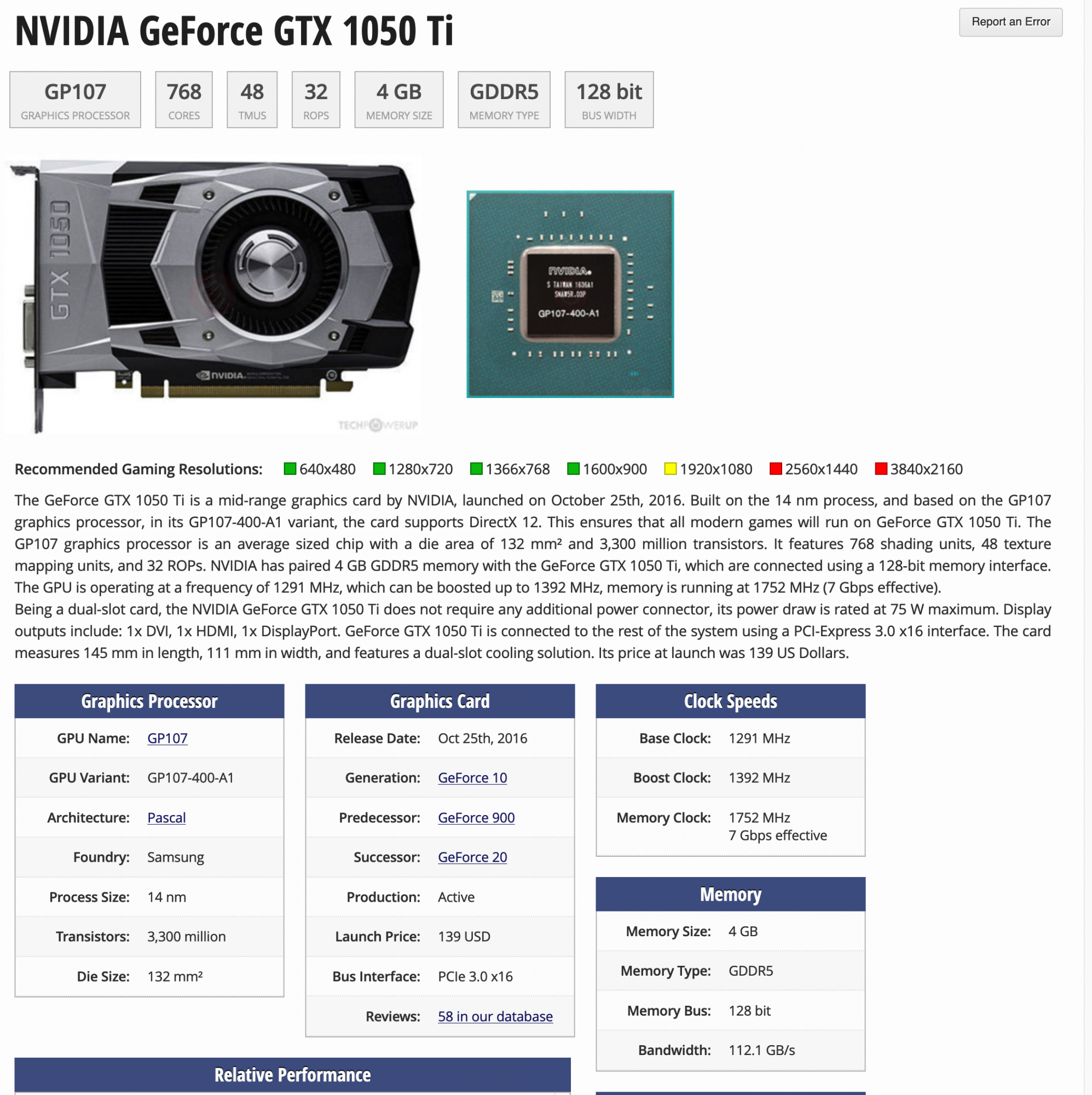

We don't know which GPU Apple compares the M1 to, but I don't think it's the 10th gen intel. The Iris Xe with 96 CUs consumes about 25W and is slower than the M1 at 10W.
AMD Vega mobile isn't better.

It's a five-year-old card on 14 nm. AMD is on 7 nm process for their APUs and GPUs today. I think that nVidia is using Samsung and 8 nm process. Intel is using 10 nm and their 11th gen stuff looks competitive with M1. Apple is likely comparing with 10th gen Intel and AMD but both stepped up their games this year.
Transition to 7/8nm didn't give Nvidia that much, roughly 20-25% at the same power consumption. And we still haven't seen the performance of the 35W 3050 parts...
We have a fairly good idea, the GPUs most close to M1's performance are the older GeForce 1050/1050 Ti (desktop) or the newer mobile 1650 Max-Q. The brand new 3050 with 30-50 W TDP will be up to 50% faster of course, but the upcoming 16-core Apple GPUs with the TDP of 20-25W will blow it out of the water.
