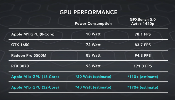

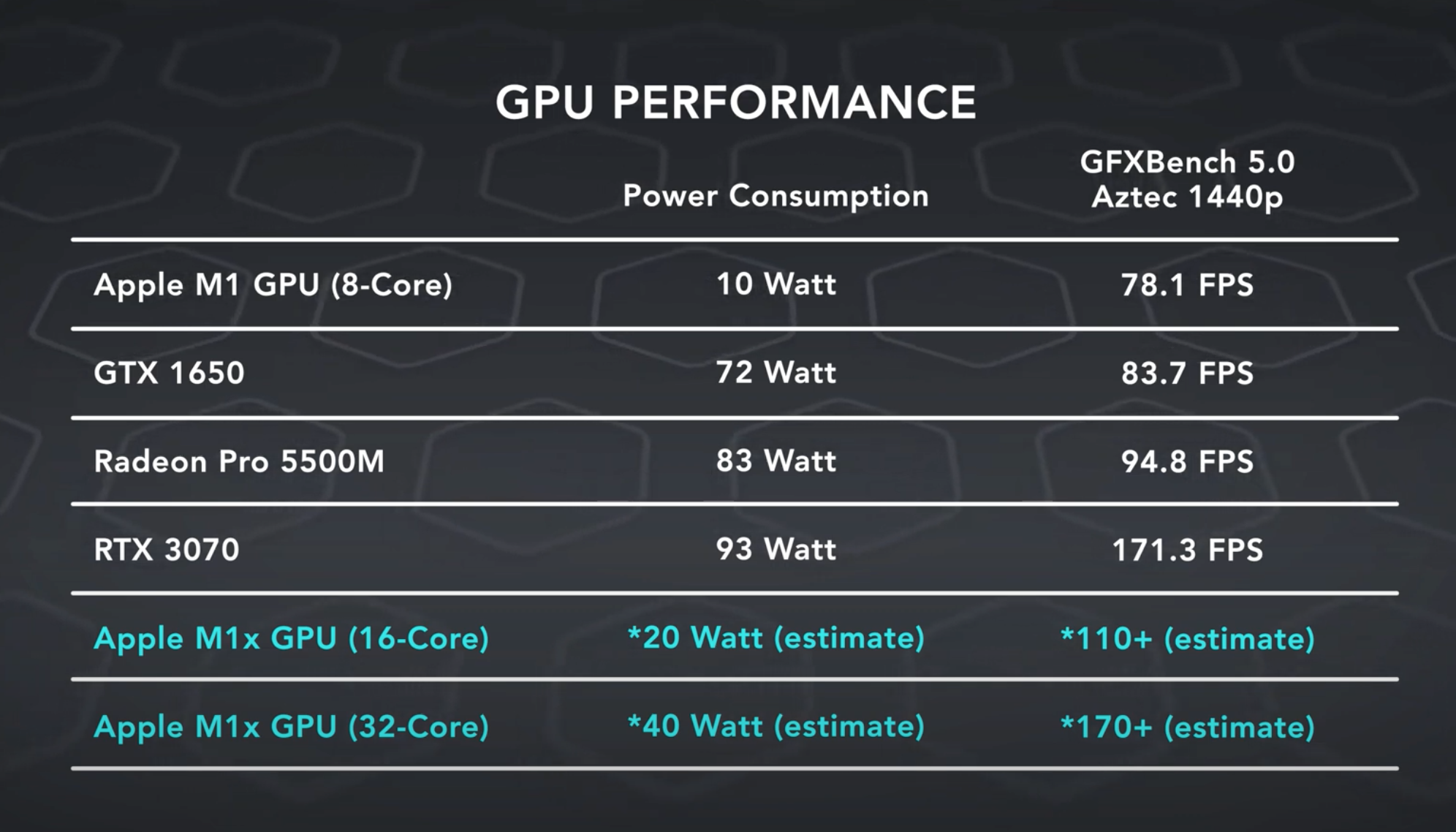

with 32 cores gpu, its clear apple is targeting the power of the mobile Rtx 3070
Remember, current 5500M+cpu 83W and that 3070 consume 93W+cpu, while this new M1x the gpu cores will consume around 40W being on par with 3070 and almost double the performance of the 5500M
So right here we can see the M1 and M2 M3 etc will remain for the ipads/ and ultrabooks/fanless devices, while these will go for larger devices, with active cooling. I wonder if the next 24" imac will get this M1x (since it has 2 fans and heat pipe) or will take the M2 from the next macbook air and keep the same trajectory
I don’t think Apple gives a rats ass about mobile RTX 3070.
It would seem that such a GPU would, very broadly, fall in the general span of RTX3060 or so performance. But it’s difficult to see that there is any overlap between products, programs and customers for the two, particularly as booting into Windows is a thing of the past.
Apple has very little reason to care about the Windows gaming laptop market. None, really.
(Your wording was a bit ambigous as to what you meant. But while Apple vs. PC comparisons are great forum war fodder, with Apple going their own way in terms of hardware architecture the markets are more distinct than they were. The number of people who consider buying either a MacBook Pro or a Windows gaming laptop has to be absolutely miniscule.)
