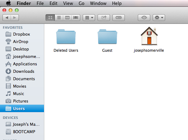

I went into my root drive (OS X Mavericks) in Finder, clicked on Go, then Go To Folder and typed in Users. I have show file path enabled on my MBP, so I drug the Users icon from the file path onto my sidebar and now I can access Users whenever I need to.
I rebooted to make sure it didn't go away and it didn't.
