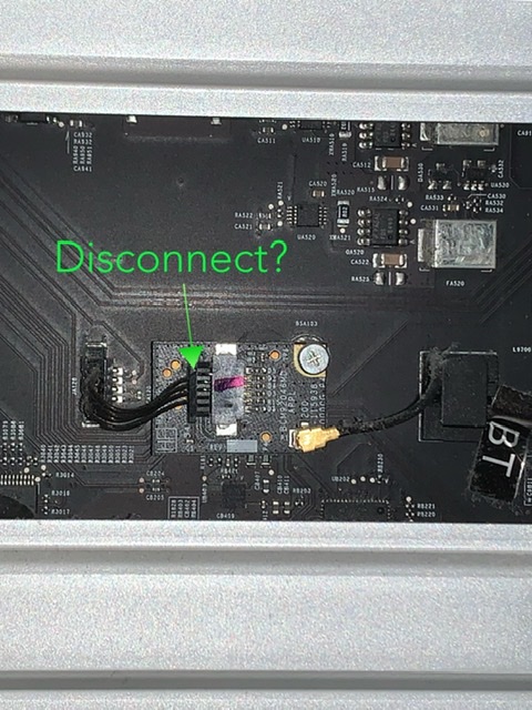

I have some trouble using my USB dongle for Bluetooth 4.0 since the older built-in Bluetooth is taking precedence.

just pull the little cable on your Backplane going from Backplane to Bluetooth.
You need to pull the cpu board to get access. This is easy and reversible, have it done on my 5.1 as well, no issues.
(not the antenna, lol)
Thanks for the suggestion! 🙂
I was thinking what would happen if I disabled the internal Bluetooth and only used the USB dongle. But would it work after a wake from sleep? That worries me a bit.
I have it that way since a few years, USB Bluetooth dongle in the USB Keyboard, internal bluetooth unplugged.
I use it for the magic mouse 2, no sleep or installation problems.
The black cable here, is that enough? The Golden one to the right is the antenna, right?
Edit:
Did it and yes, it worked!
Now there's no confusion when waking up the computer from sleep – the USB Bluetooth 4.0 dongle is still kicking!
Thanks!
