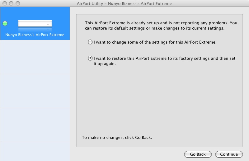

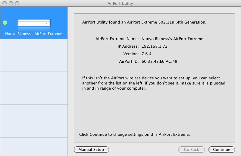

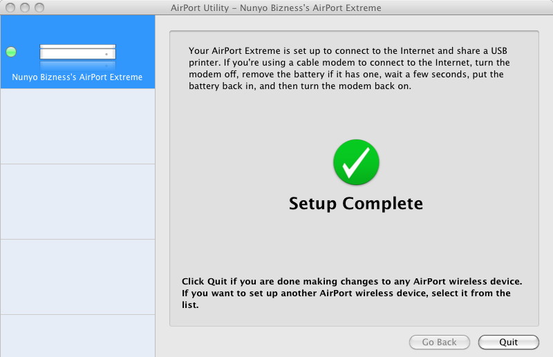

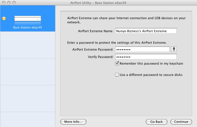

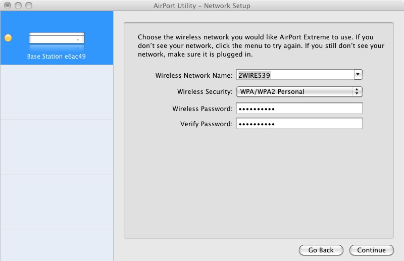

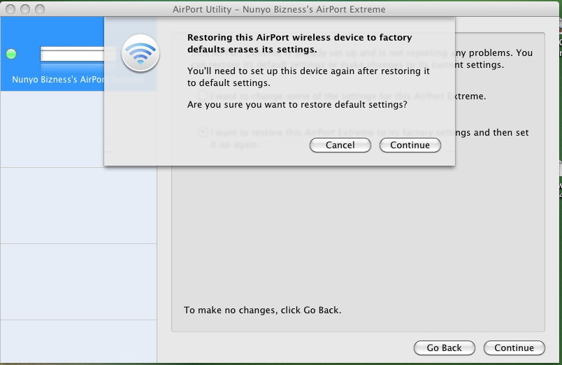

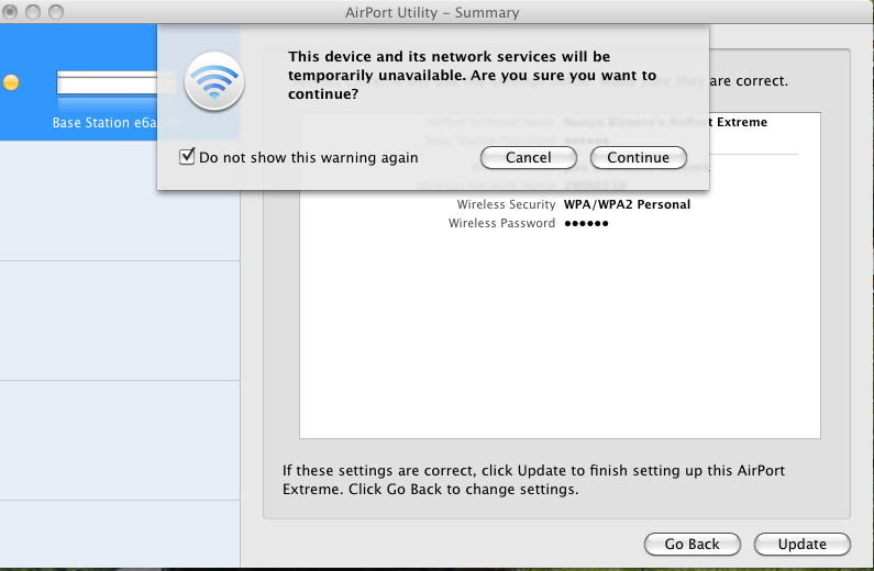

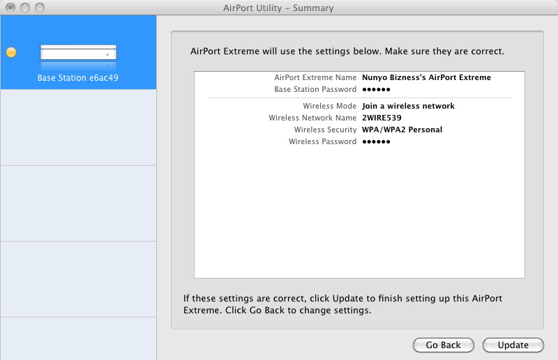

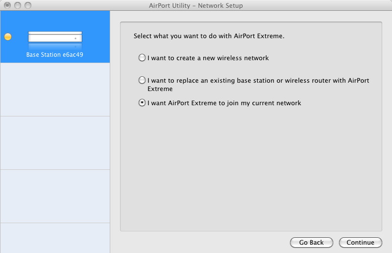

Im using Airport Utility 5.6.1... I took screenshots of each step I took:

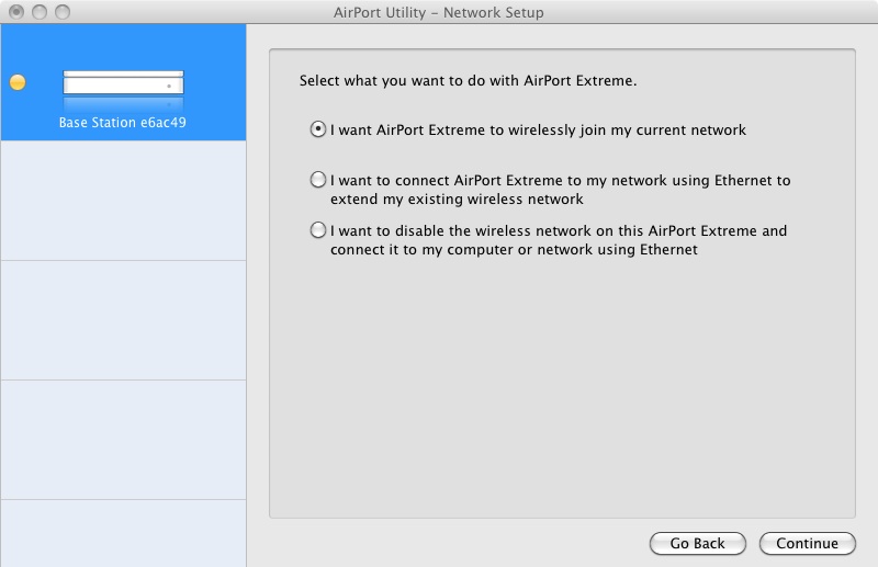

and:
And you still are unable to connect Ethernet clients? This is a functionality that is coded into the firmware and it worked on my 3rd generation. That being said, it appears that the functionality works for some and not for others. In my case, it worked with one Extreme and not the other. The USB port worked regardless of generation.
In summary, in a way eduardw was indeed correct that it is officially supported in the AirPort Express and will work every time on a wireless N model. That also being said, the Extreme is capable but it is touchy to say the least.
