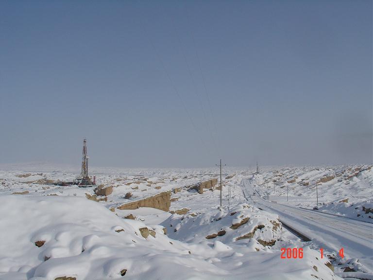

Snow in the desert - Taklamakan circa 2006
