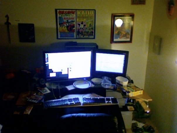

can you post the pic of your setup?😀
two keyboards at once would be funky...🙂
Picture attached. The desk is a work in progress!

Thats pretty cool! how do you use mouse?!
I've always been a trackball user. Right now it's just hanging off the edge of that part of the table (used to be on the arm of my chair). I'm going to move it somewhere closer, but I haven't decided how yet.
