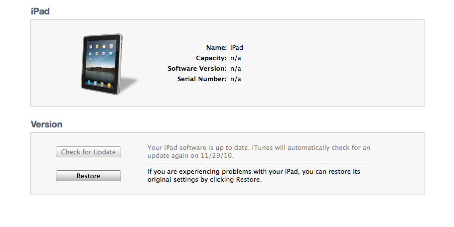

does anyones screen look like this? Screen shot 2010-11-22 at 8.15.42 PM.png
Is your iPad in recovery mode? Use a program to kick it out of recovery or use the power and home button. Once you do that, your screen will go back to normal.
Thanks
AE
yup its in recovery mode and i thought i could restore from a backup but i guess not when i control click my ipad it do sent give the option
Sorry I didn't get the last part of your sentence, when you control click the iPad does what?
If you don't know how to kick the iPad out of recovery, google search, kick iPad out if recovering mode and find a free program that will do it.

sorry im frustrated and hungry...what I was trying to say is that my iPad wont let me use a back up to recover. When i use control and then click the iPad icon it should stay restore from back up but it doesn't. I'll research that now kick out thing now!
Hi,
Just kick it out of recovery mode using a program and it will go back to normal. The iPad will turn on normally and will be recognized by iTunes normally as well. Make sure that iTunes is turned on when you use that program to kick it out of recovery and that your iPad has that screen with the iTunes logo and USB.
Thanks
AE
OK. THIS is weird but it works.
Go to Apple.com download iTunes again. Re-install it.
connect your iPad again.
Follow instructions.
Congrats! You updated your iPad with iOS 4.2.1
