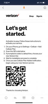

All, I got this to work via VZW Chat.
1. Ensure your phone is within good Wifi range.
2. Physically remove the SIM from your Verizon phone. I had to do this, otherwise the IMEI kept returning to IMEI1.

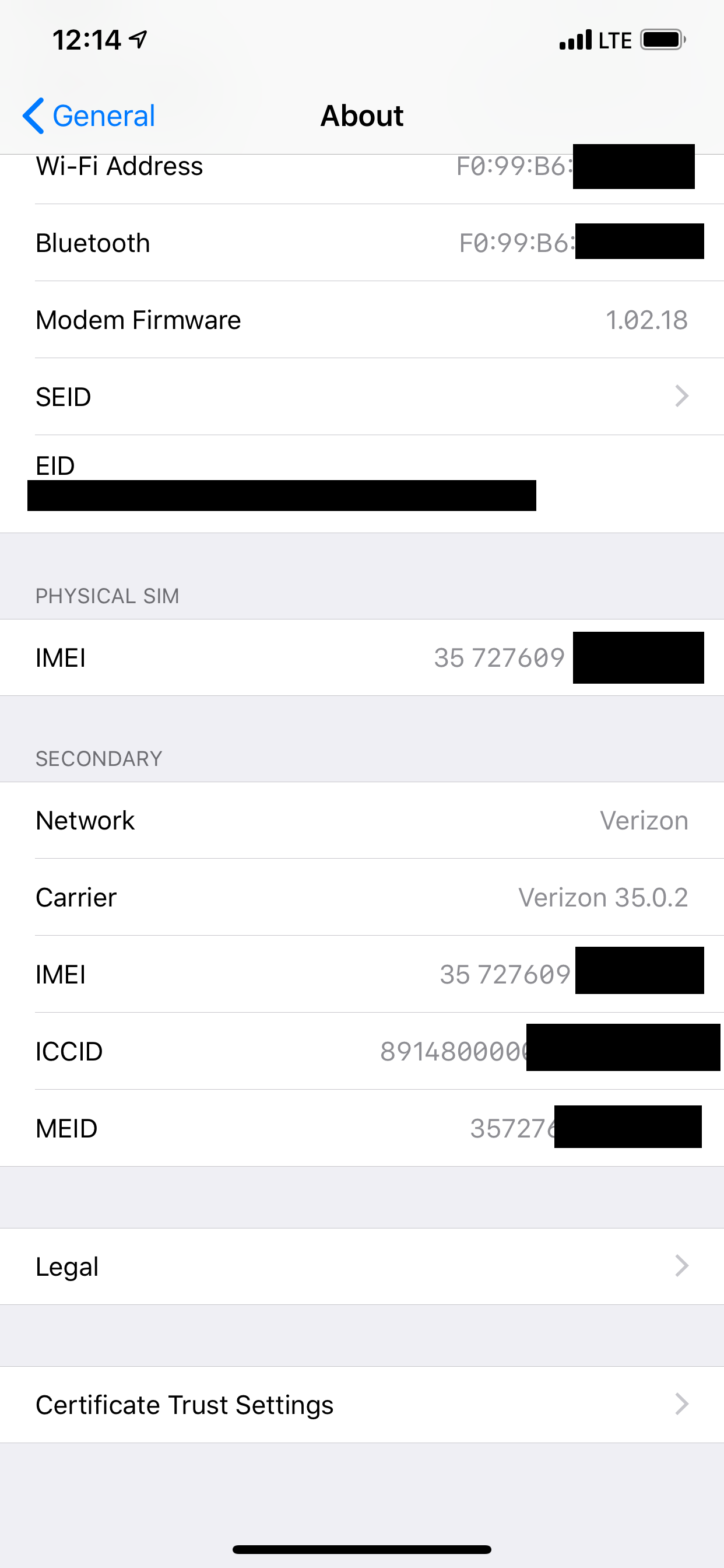

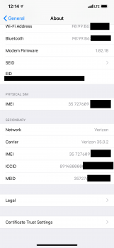

3. Open a chat with VZW, ask to "Force change the IMEI" for your line.
4. Provide IMEI2 (listed under "Secondary", in Settings > General > About).
4a. If VZW asks for an ICCID (Sim Card ID), tell them "Please keep the currently assigned ICCID".

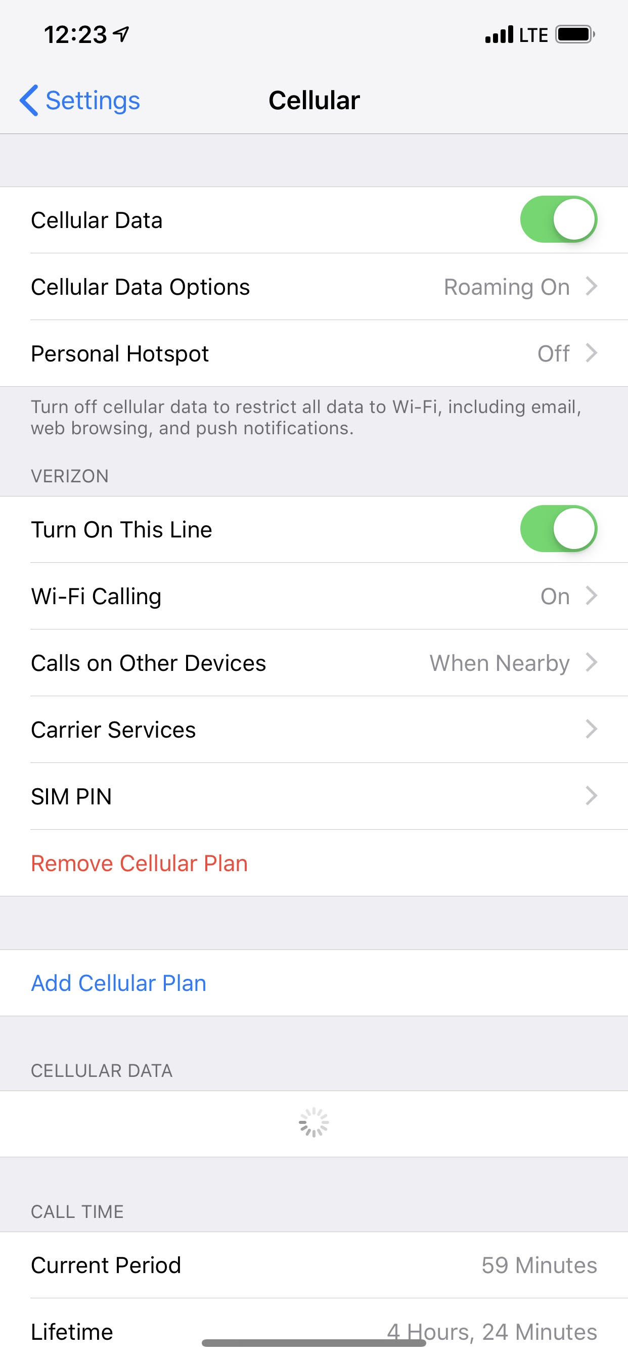

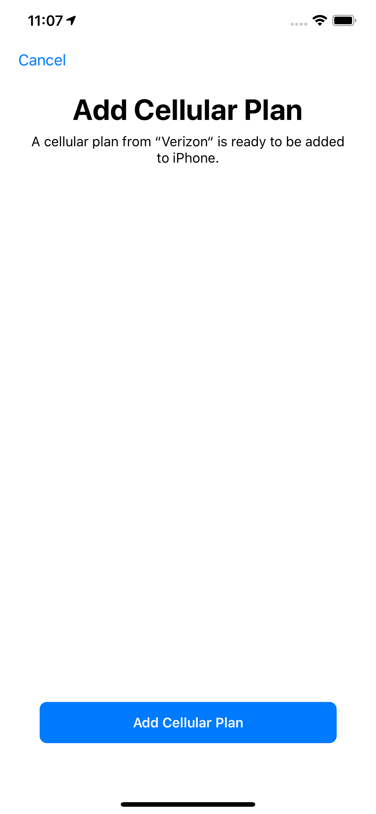

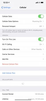

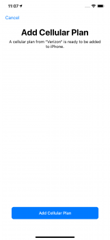

5. When the rep says to reboot, don't reboot, but open Settings > Cellular > Add Cellular Plan.
6. Scan the QR code attached to this post.
6a. If you get the "Cellular Plan Cannot be Added" error, try again in 1 minute. If you keep getting the error, ask the rep to confirm the IMEI change is complete. Again, your physical SIM Card MUST BE OUT OF YOUR DEVICE, otherwise, the IMEI will return to IMEI1 within Verizon's system... ask me how I know this 😀
7. The eSIM will activate. For me, this took about 2 minutes.
8. Once activated, it took another 3-4 minutes before LTE signal came in... it sat between "No Service" and "Searching" for a few minutes. Honestly, I hope this improves, because I was somewhat nervous if it was actually working.
9. I confirmed a test call to #832 worked, then thanked the rep for their time.
YMMV... but, enjoy eSIM if you're able to get it working like I did!
Thanks! Is your screenshot showing what it looks like after it was done? Mine says 'Physical SIM' and 'Digital SIM'. Is your eSIM on Primary or Secondary?
Yes, the screenshot was taken after...
It likely says secondary because I had an eSIM for GigSky before, which was the secondary SIM (albeit, it was named "GigSky").
Confirmed, I just popped in an unactivated T-Mobile SIM, and it allowed me to change "Secondary" to whatever i'd like.

Is anyone having issues simply scanning the QR code? As soon as the camera sees black and white it captures the image whether it is on the code or not; unlike most of the time where it will register the code and then focus in before capturing.
Reactions: cwosigns
They want me to call telesales and add it? or activate it? Why isn't anything with carriers smooth?
I got a rep to update my IMEI and after a few minutes (like Topher mentioned), I was able to scan the QR code and have it work. It doesn't need to be perfectly in focus.
But now I'm having issues with it actually providing data and cell service. It shows full bars, but nothing works....

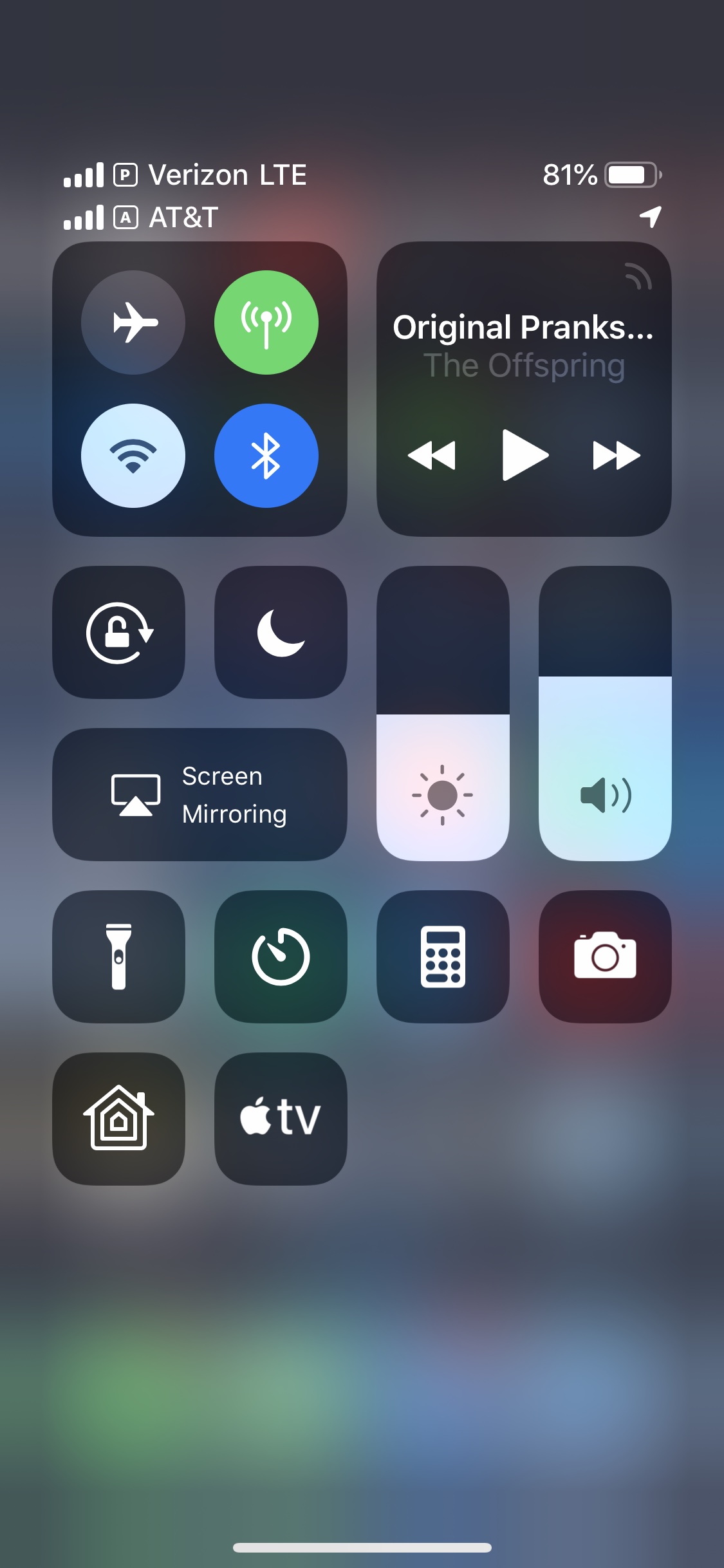

got it to work, followed the instructions exactly as above. i guess i got lucky and had a rep who knew what to do. dual sims active

I’m a current Verizon subscriber. If i wanted to move my Verizon service to the eSIM and leave a Google Fi SIM in the slot, would it be possible to use the Verizon one for daily use, then simply switch to the Fi SIM for travel?
Reactions: DCIFRTHS
yea that should work fine. you can leave the fi sim card in and just disable it in the settings, then when you want you can turn it on and use it (you can individually toggle each sim on and off).
