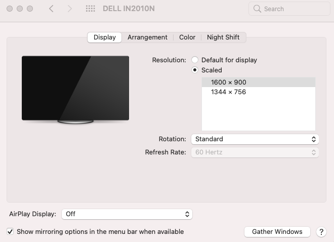

I am using the 1600x900. I have tried others but the stretch or don't fit the screen.
1280x960 It was hard to find but I did. I would have never looked there. It was at the very bottom.
Yup. That's a 4:3 resolution. If you can't select 1600:900 at the monitor, then you could try a different adapter, but at this point I'd consider getting yourself a modern 24" 1920x1080p IPS monitor, which isn't expensive.

If the monitor reports 1280×960 while macOS simultaneously reports 1600×900 this might suggest 1600×900 is just a scaled resolution macOS forces onto a 1280×960 output.
In other words, something’s not quite right. The issue could be with the particular combination of monitor and Mac/OS or the adapter.

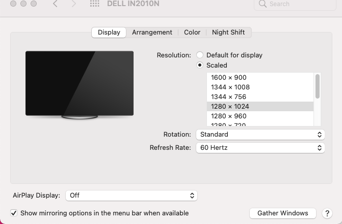

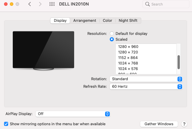

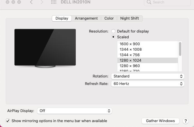

I clicked on option to get the additional resolution options. It took two screenshots to get all of the resolutions. I am using 1280 x 1024.
Below is the original.
Wait a minute. Using 1280×1024 on a 1600×900 monitor is going to result in a weirdly stretched picture. That's normal.
What happens if you select 1600×900, i.e. the native resolution of the monitor?
