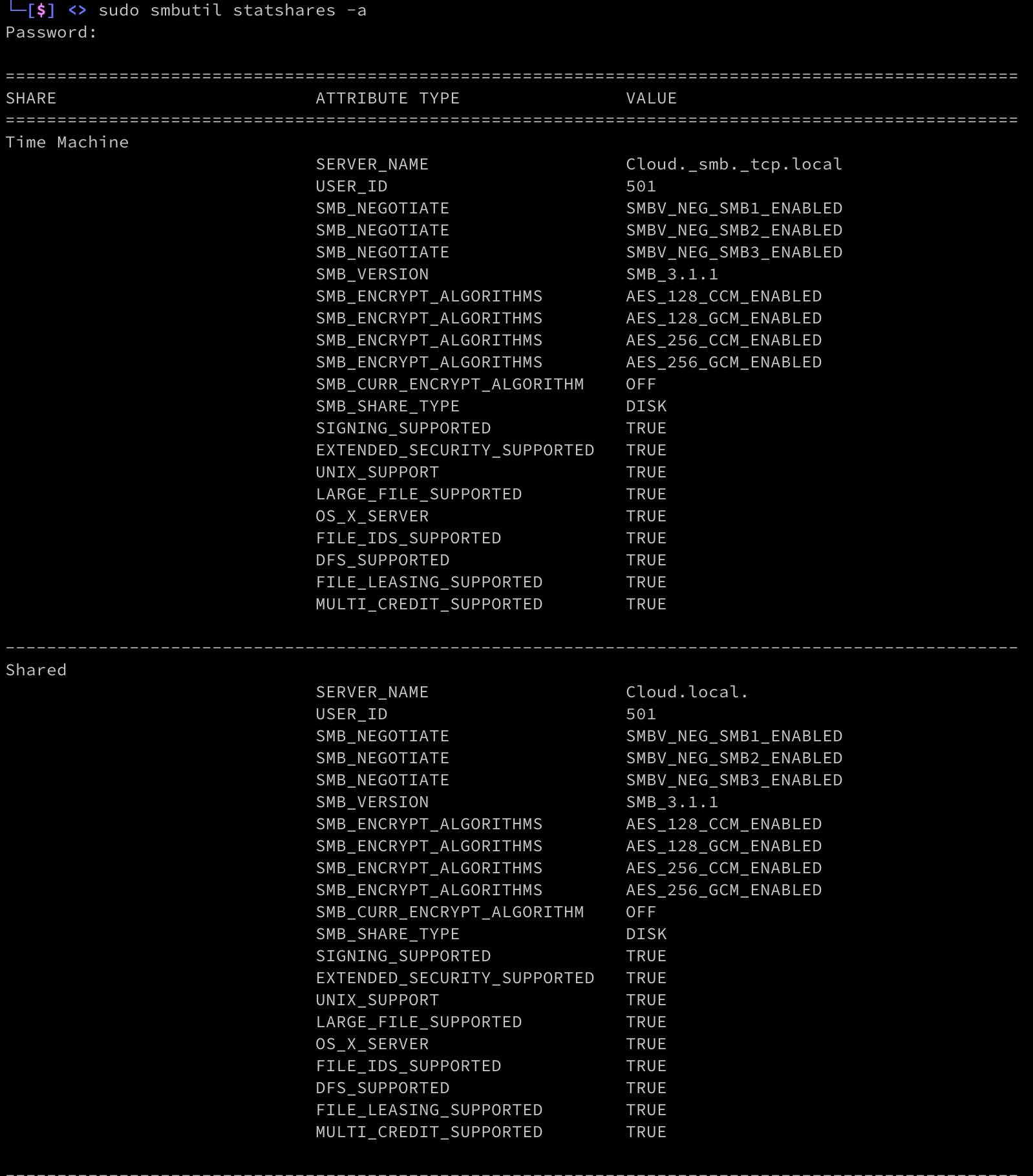

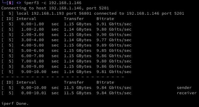

I'm having similar issues. I just upgraded my network to 10g to try and fix some of the speed issues but for some reason SMB seems to be really unreliable to my Synology NAS (which is think is very similar to QNAP devices). When running iperf3 from my M1 Max MBP I get sustained transfer of 9.9Gbit/s to the NAS but when copying files through finder or forklift to the SMB share, it caps out at 250MBps. I don't really understand why this is. I have 4 enterprise HDD disks and im able to sustain 1100MBps easily with the hardware but for some reason SMB on macOS is garbage. Sadly I don't have any other systems to test on but I was hoping someone would have some answers here.
Here is the SMBUtils iperf3 output:

I'm using a docker container on the Synology NAS with iperf3 server and running the client on my laptop to get those results.
Also if it helps I'm using a Synology DS3622xs+ with 1 of it's 10GB ports used. No link aggregation or anything.

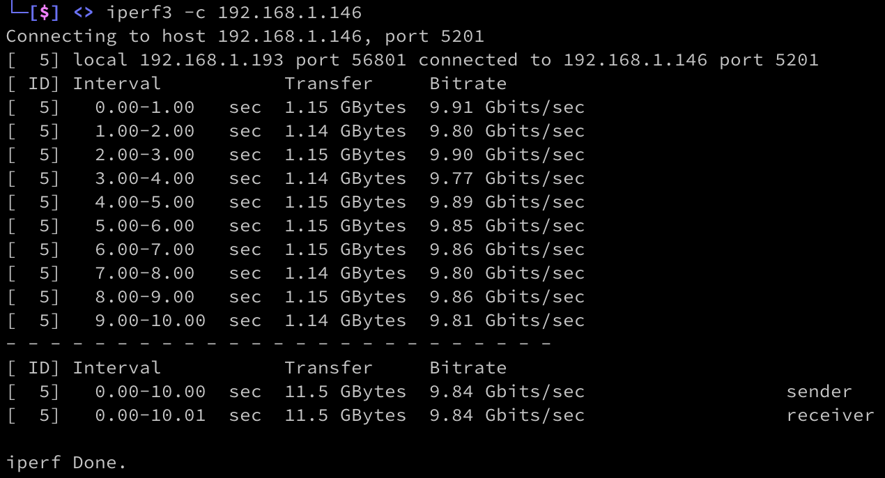

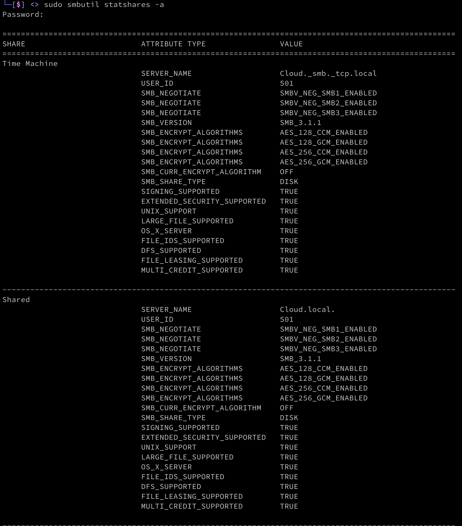

After a doing a bunch of research it seems to be the encrypted share that's causing the issue. I purposely bought the ds3622xs+ because its had a hardware encryption module so I was hoping the encryption overhead would not be that severe but on encrypted shares I can't get much more than 250MBps. This is really frustrating because the resource monitor shows the NAS basically idle during the transfer so I wish there was some way to tell it to allocate more resources to the encryption process to speed it up. If I do an SMB copy to an unencrypted share on the same volume I get the full 1100MBps. Also reading from the encrypted share is full speed (~1100MBps), only the write operations are slowed down to 250.
Also, my first attempt at 10gb was really bad. The cables I was using were apparently broken some how. They showed a link and it appeared everything was working but my speeds were really really slow. I replaced the cables with a different more trusted brand and I was able to get max speed. I capped out at 6.5-7Gbps until I enabled jumbo frames on everything as well, that brought me up to 9.8-9.9Gbps fyi so I'd recommend doing that if your networking hardware supports it.

I would follow this guide to setup iperf3 on your Synology and run the command from your desktop to test your raw throughput to the nas. This is what I used to diagnose connectivity issues and figure out I had bad cables: https://ltroyalshrimp.com/how-to-run-a-local-iperf3-speed-test-server-on-synology-nas-in-docker/
