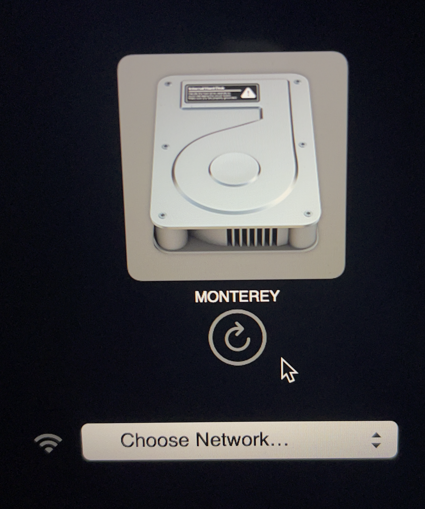

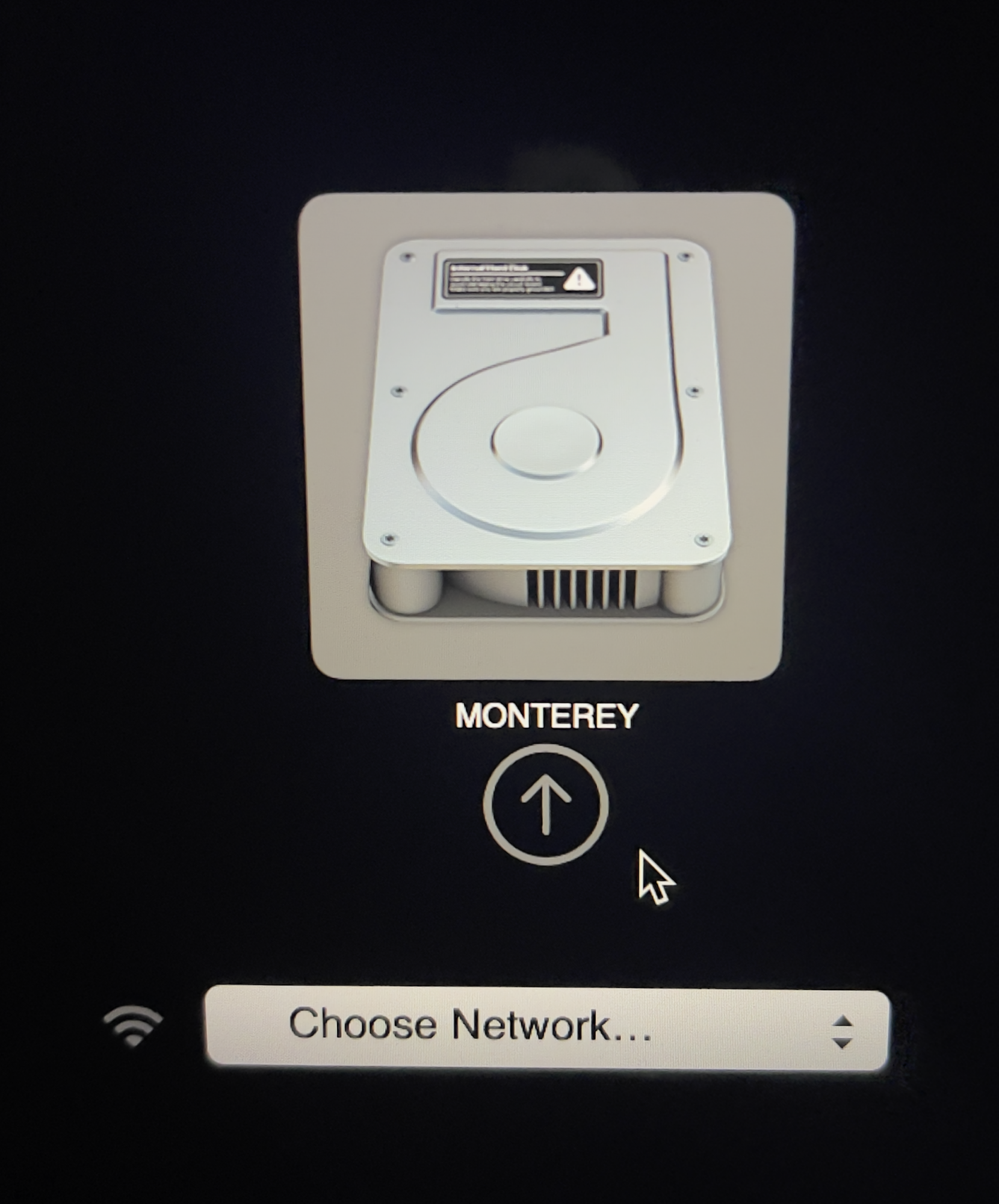

you can try this.
shut it down. while turning power on, press and hold option tab.
Now press and hold Control tab, and click semi circle arrow.
