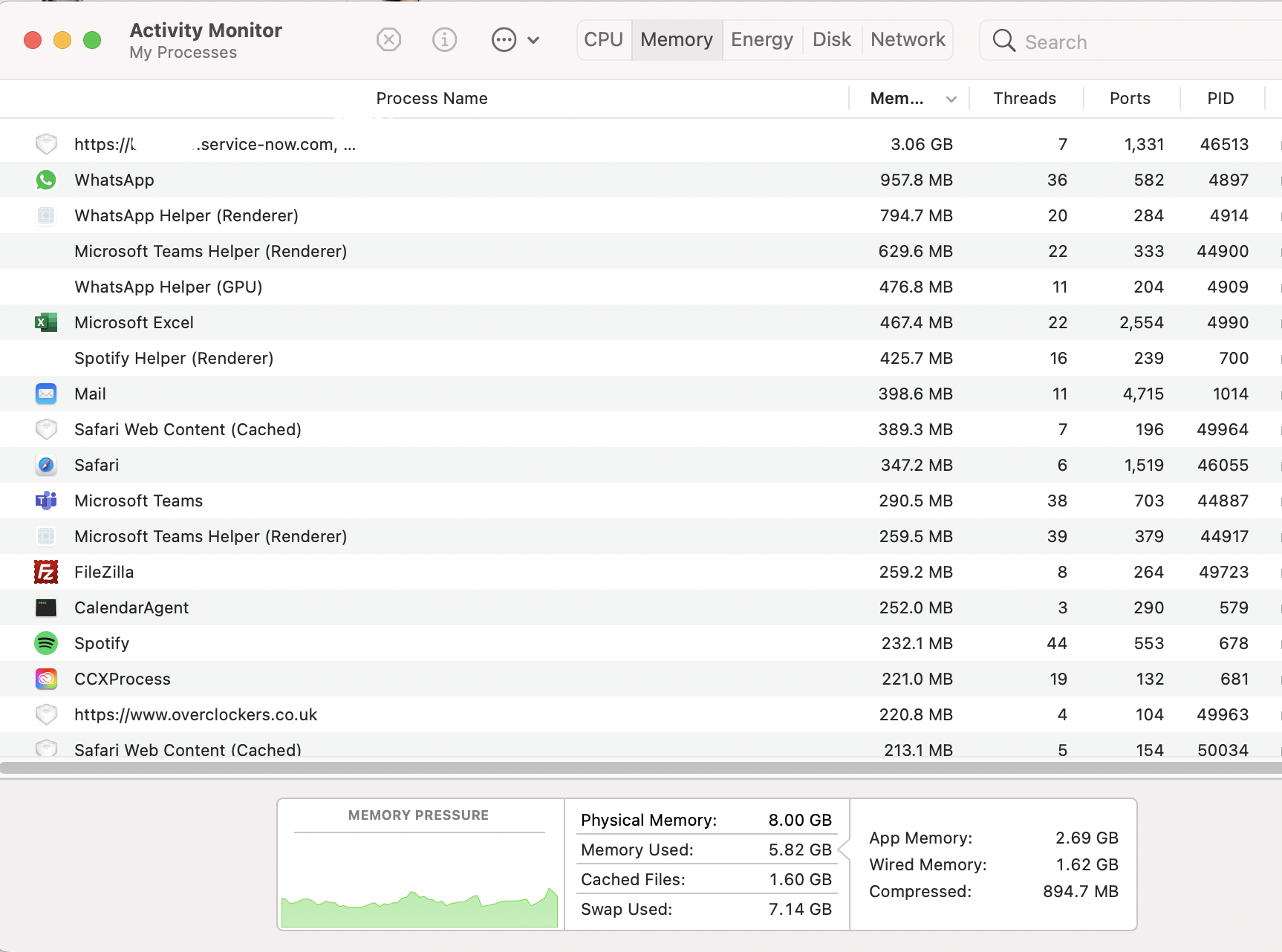

Mine will happily sit in the green but still I'll have those issues.
Pressure looks good, but it was definitely noticeable that the system was struggling.

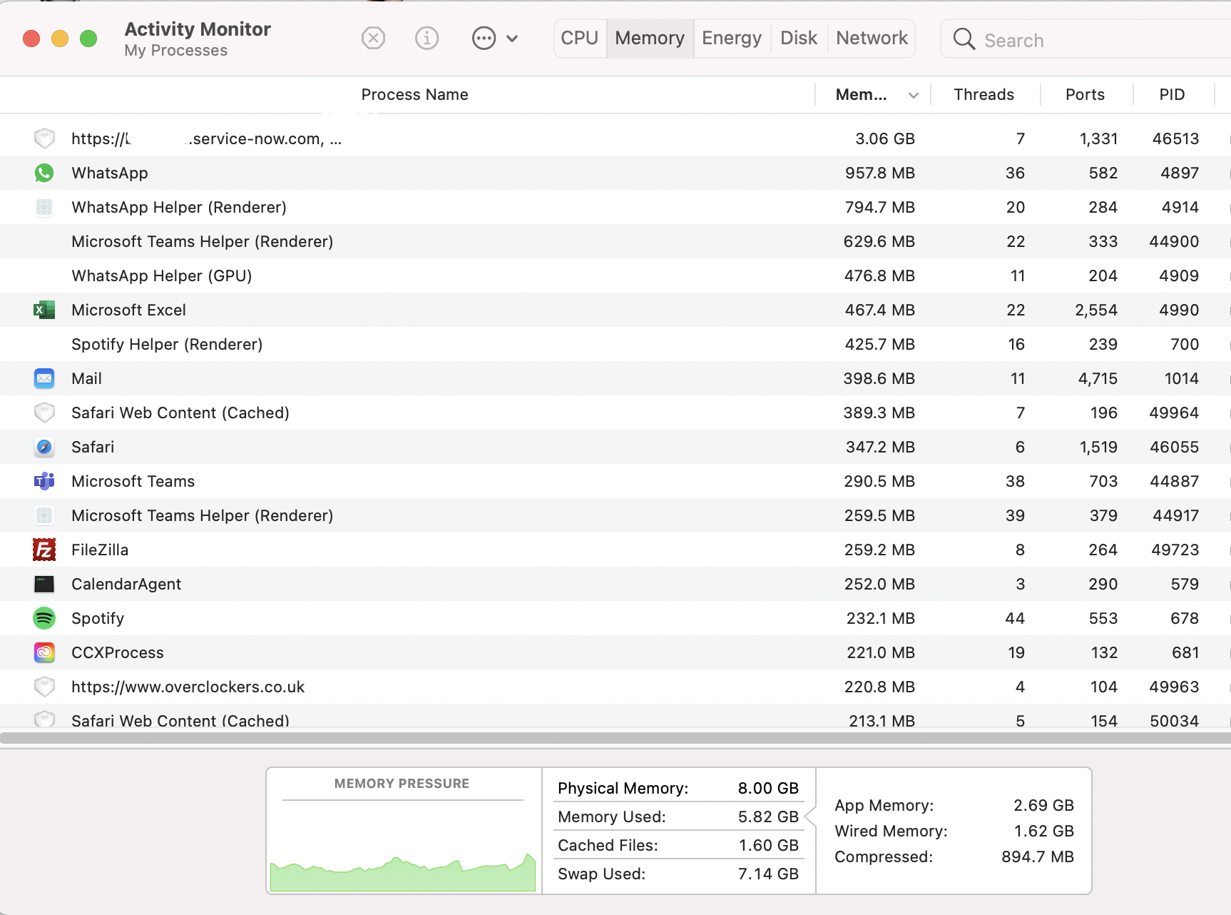

Out of curiosity, can you check the Disk tab as well (it may take a few seconds before all fields are filled with data) ?
Also, what is the top process occupying around 3 GB of memory ?
EDIT: The Apple support dokumentation says, if the memory pressure is red, orange or contains lot of bumps, you may need more memory, so your observation may be correct since your memory pressure is bumpy as far as I can tell.

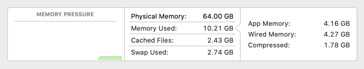

Uh... I have a 64GB 16 inch and that's normal. It always does that even when I'm not stressing the RAM. The TBW of the SSD is way too high for that to meaningfully shorten the lifespan.
