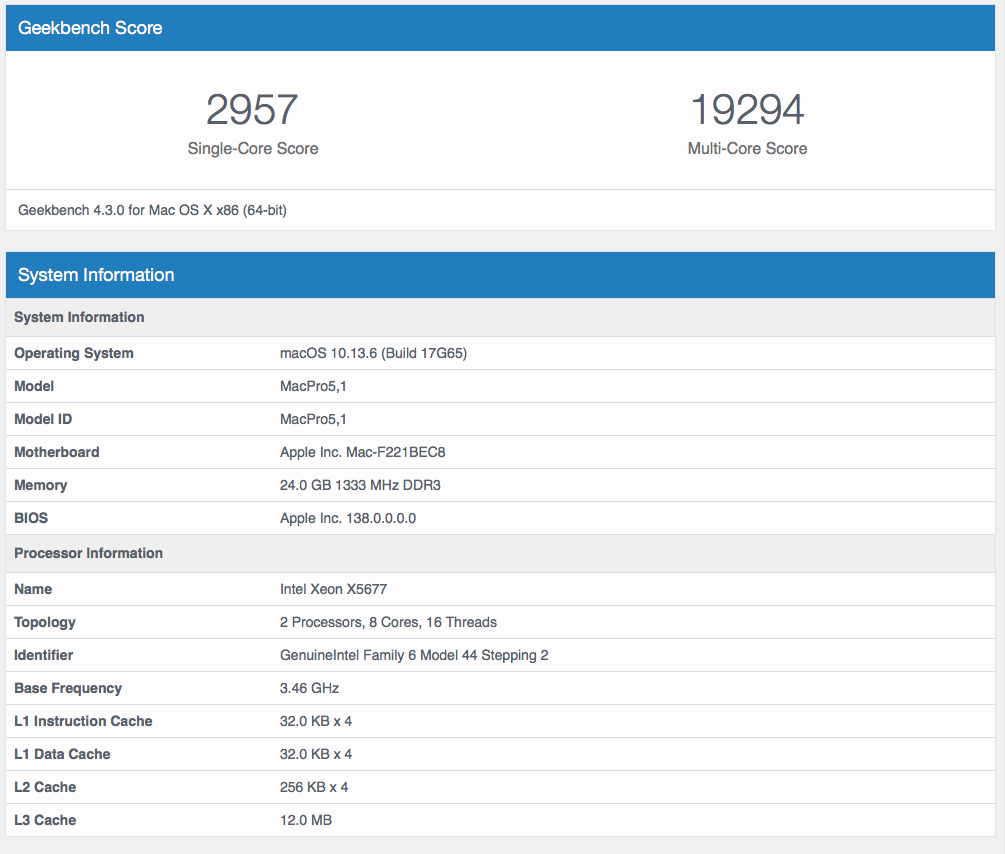

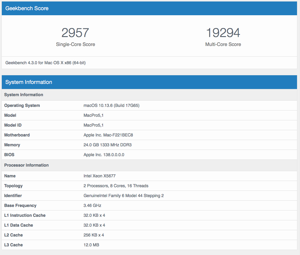

This may give you an idea as to what to expect from a dual x5677(geekbech) and a dual x5680(geekbench)
The dual x5680 is worth the additional $50.
Honestly, I didn't think a pair of X5677s would score 20000... let alone 21000. Seeing that score confirmed my resolve to purchase a pair and at least test them out. Thanks for that link.

^^^^Just for $hits and giggles I just ran mine:
Lou

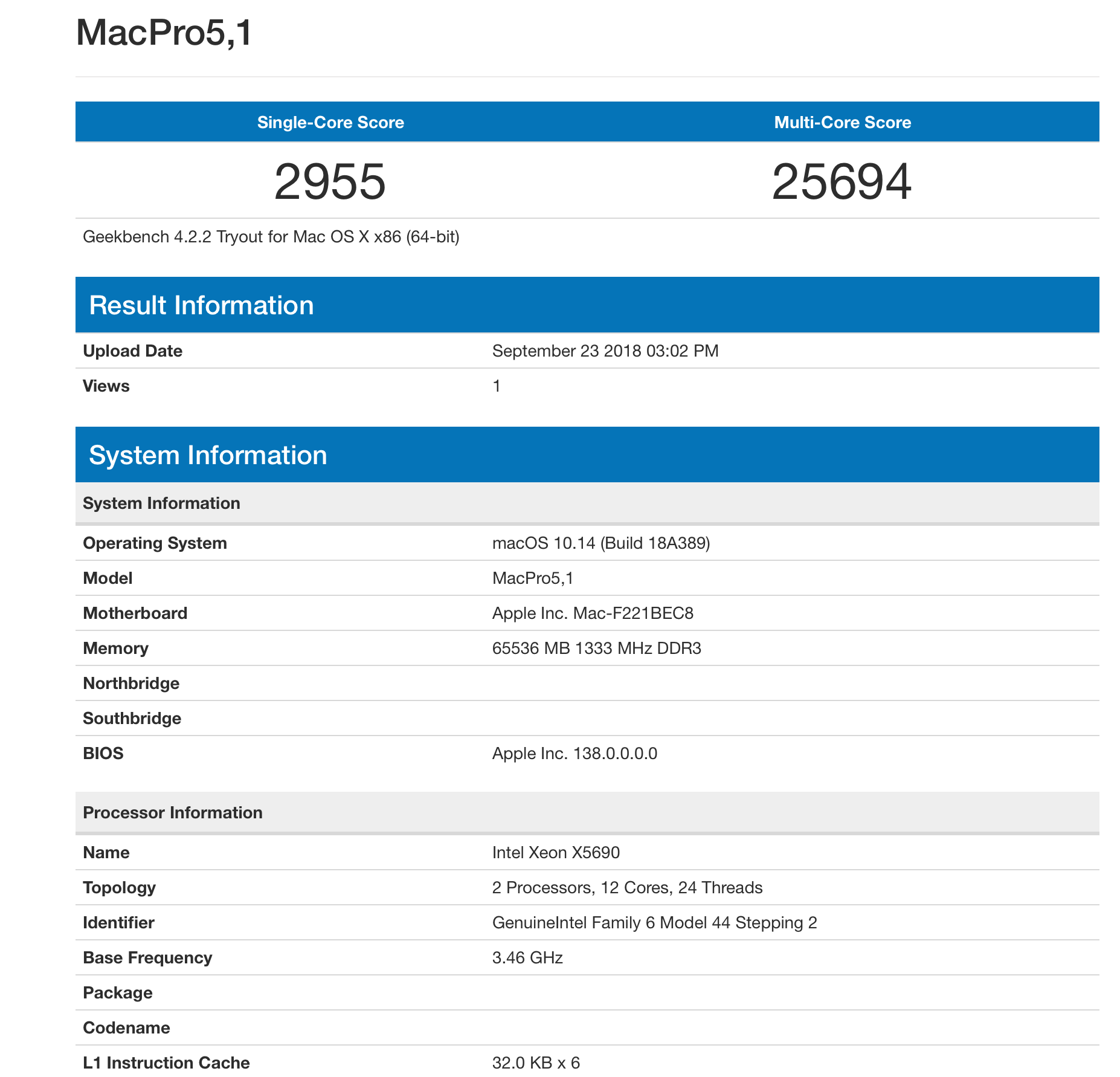

I upgraded to 12 cores X5690s for FCPX. It's a worthy investment considering I will continue using the cMP for as long as possible.
BruceX test: 16-17 seconds
Geekbench scores....
