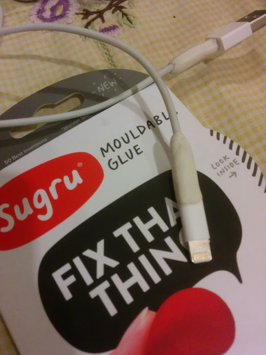

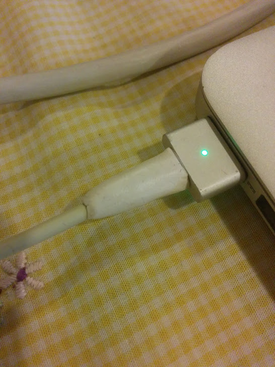

I've always fancied trying sugru - https://sugru.com, might try it sometime, looks like it would be better than the self fusing tape that I used to fix a damaged cable
I actually used Sugru on my macbook charger, and my iPad lightning cable before it started the inevitable fraying. Works like a charm!
PS: I am super gentle with my cables, wrap them carefully etc, but Apple uses thin silicone for cable insulation, not PVC as other manufacturers do - as a result it isn't as durable. I abuse my PVC cables without any fraying for years.

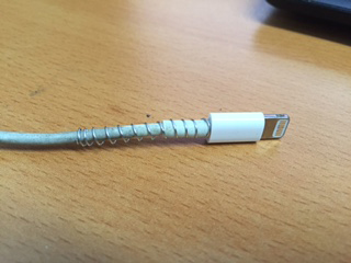

Or you can just use a ballpoint pen spring, wrap it around the end of the cable creating a nice strain relief. I've done this on several of my lightning cables, since i no longer own any Macbooks.
